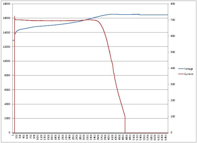

    the chemistry seems to have reset when I programmed the latest firmware. I've fixed that and I have connected a different battery pack, so we can rule out any issues related to the battery. The battery is a 4S1P, 6,8Ah LI-ION pack (SAFT MP176065N). The wires to the battery pack have also been shortened, they are now about 10cm long. The Term V has also been set to 12000mV as you mentioned. The charge profile now looks like this:
    The voltage drop at the right of the graph was caused by me, because I restarted the logging sequence.This seems to be a little bit better, but the constant current is still not what  I set it to (1000mA). Using a lower current (IE 500mA) doesn't change the shape of the charge profile by much.
    I'm using the BQ40Z60 EVM, not a custom layout.

    Are you working two problems here? I have made comments on both the cell balancing issue and the irregular charge current profile. I tested your srec on my pack and did not see the irregular charge current profile. There must be some other issue, since we are using the same type of hardware and firmware. You mentioned that you have long wire running from the battery to the EVM. Could you take a picture of your complete setup and I can try replicating that. Maybe we can find why we are getting different results.
    Tom
