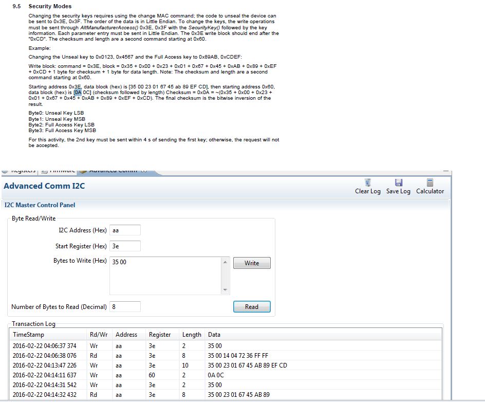

  • To unseal the gauge, you have to send the two word unseal command one after the other.  The time interval between sending the commands should be less than 4s.
    See an example on how to use the advanced i2c command window. Here i am changing the security keys as described in the technical reference manual snippet.
    To read unfiltered FCC, The command is 0x0073. See TRM for additional details. To read Unfiltered FCC using the advanced comm i2c window, see snippet below.
    additional example on how to change data flash parameters via command is in the email attachement below

  • Hi Onyx,
    Customer is following the same procedure as describe but unable to change the security key.
    Please let me know the software flow when I will do all this activity by I2C not by battery management tool. As reading the manual it is clear that in order to work first its required to authenticate the gauge and then unseal and afterward gauge feature is accessible to user.

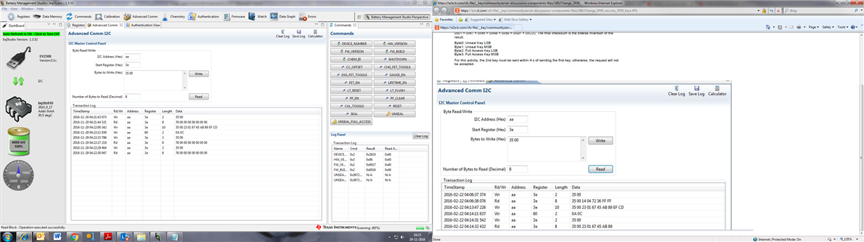

  •  Hi Team,
    Customer tried to follow the given sequence to unseal the gauge and not able to get the setting/read backs as explained,screen shot attached for reference.
    For voltage,current and temperate advance communication mode readings are not matching with register tab, attached screen shot.
    Can you please help with your inputs.
    Thanks, Shinu Mathew.

  • Hi Shunu,
    It looks like the gauge is sealed, so you don't have access (rd/wr access to change the seal code and the security key). The snapshot from e2e is showing how to change the unseal code and security key, but before doing so the gauge must be unsealed and full access enabled. If you've sealed the gauge, most likely you did so with the default codes. used the command tab in bqStudio to perform the unseal and full access for bq28z610. Send unseal command then full access command. You can refresh the SEC1 and SEC0 bits in the register tab to check the status of the gauge. Full access security mode is need before following the steps for changing the codes and keys referenced in your post above.
    SEC1, SEC0 (Bits 14, 13):SECURITY Mode
    0, 0 = Reserved
    0, 1 = Full Access
    1, 0 = Unsealed
    1, 1 = Sealed
    See page 47 and 48 of bq28z610 TRM
