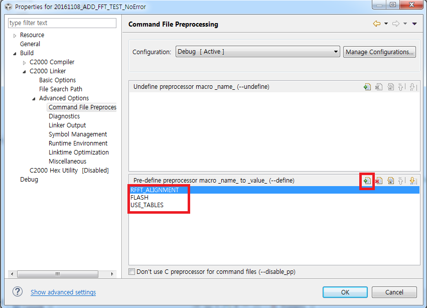

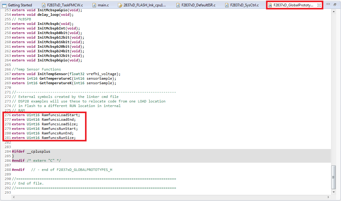

    After few hour, I trying to add the FFT_Twiddles which I missed before.
    But the warning message was appeared in this line "--library=c28x_fpu_dsp_library.lib<RFFT_f32_twiddleFactors.obj> (.econst)"
    The message is no matching section... maybe I failed connection..
    How can I match the this file(RFFT_f32_twiddleFactors.obj)???
    I atteched my code again.

  • I need to some kinds of procedure to allocate the  RFFT_f32_twiddleFactors.obj on my exist project file.
    now I just conntect the twiddleFactor.obj.. so I am testing the FFT result is right or not.
    so.. I attached the some kinds of pictures what can I do to allocate the twiddleFactor.
    If I had a wrong on my project, please tell me what is mistake.
    1. Define to operate FALSH mode and USE_TABLE in cmd (Project Explorer -> "your operating project" -> properties)
    2. Modifying cmd file (I didn't set the twiddleFactor on not external sram but flash rom)
    --define RFFT_ALIGNMENT=512
    #if !defined(RFFT_ALIGNMENT)
    #error define RFFT_ALIGNMENT under C2000 Linker -> Advanced Options -> Command File Preprocessing -> --define
    #endif

    3. Modify the Sysctrl.c
    4. Modify the GlobalPrototypes.h
    I think it is lucky..
    When I cheked the disappear the wanning message on cmd file, I had prayed for God.
    I hope that the FFT result also will be reasonable.
    Finally, Thanks for good advise, Vishal.
    If anybody tell me advise or something to set the FFTtable, reply me again.
