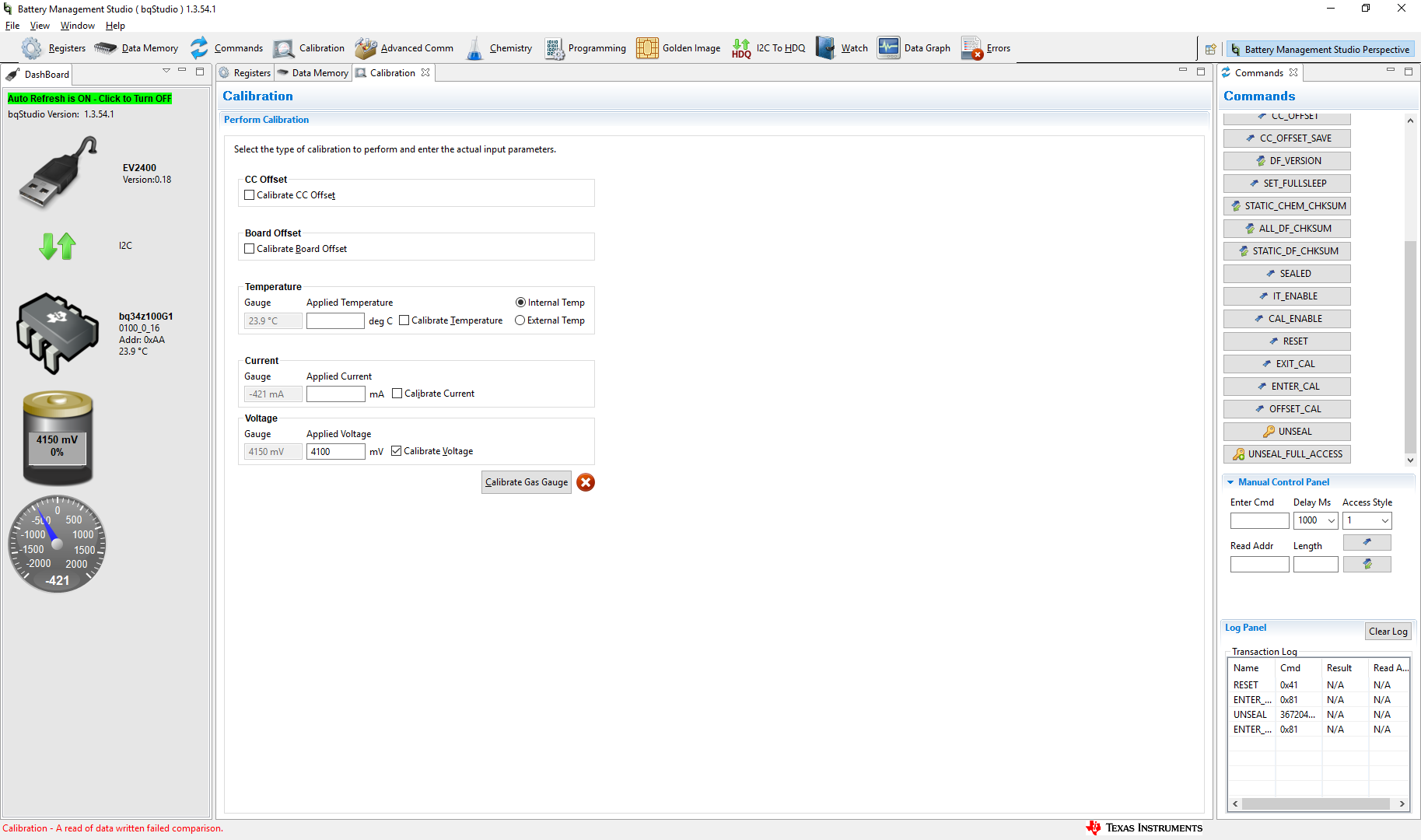

  • Hi Lukasz,
    I will need to see the log. You can go see the picture below and it will create a log file automatically.
    Miguel

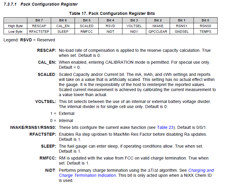

    I have a few more questions, but some initial findings show a bit of things that I need you to perhaps look into.
    It seems that in your gg file under the Pack Configuration you have set 41d9 which according to the DS
    So with this you have VOLTSEL to 0 which means that the internal resistor divider is chosen, but this is only for single cell packs. You will need to set this to 1 and use an external voltage divider.
    Also your CAL_EN is enabled, i believe this should be set to 0 by default.

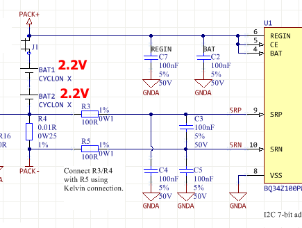

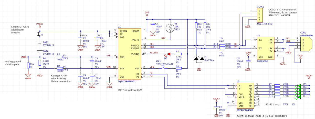

  • Thanks for answer Miguel,
    1. Yes I do have VOLTSEL to 0, since I have no external voltage divider. I am using 2 serial connected cells 2V each. This part was confusing for me- should I trick the BQ to think that I am using a single 4V cell? How should this be configured? This is my schematics:
    Do you suspect what could be the case?
    2. Yes, I do have CALEN set, as I forgot to turn it off. Can it affect anything?
    Also, did I choose the chem ID correctly? I have simply taken the Enersys cyclon battery with 2500 mAh capacity. Mine is 5000 mAh and I have set that. Is this approach correct?
    Do you know what could be the case? The SoC keeps jumping between 0 and 100% for me... I am clueless now.
    Can you please add an external divider, since the BAT pin has to be around 1.5V or below. So this is probably why it is not just putting 0% capacity since it configured to work under single cell at the moment. Also please turn off CALEN.
