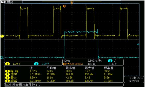

When I probe the SW signal, I find that the SW signal of the one board is always like this.

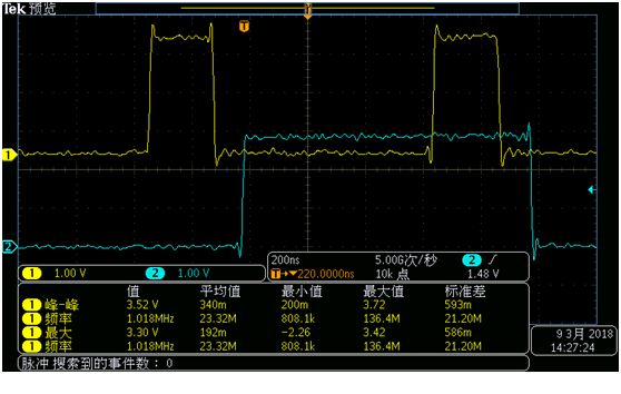

When the current is increasing, the SW signal of the another board become like this.
I point out the unusual waveform with red cycle.

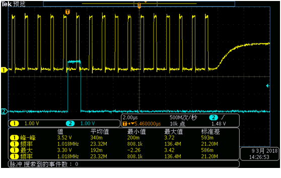

When the width of the unusual waveform increase, the FLT condition occurs.
channel 1 is SW and channel 2 is FLT.
Why?

  • Xiao,
    Before you replied, my apps team also added the following:
    "This is a strange behavior. The low side would turn off for 20-100ns after it is turned on. This doesn’t look like OC since the low-side shutdown is not latched and it happens when high side is off.
    I would suggest check whether PWM input signal is clean. Also, do a swap test to see if the issue is related to the board or the device."
    Sounds like they think the device might be broken too. I will relay the information above to them but in the meantime, do you have any more samples that you could try to replay the UCD7242 with?

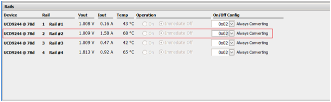

    Here is another question:
    The GUI still report some current(about 200mA) on both channel when there is no load .
    Why?
    I think that the main reason should be the noise.
  • Xiao,
    See our team's response below:
    From current sense signal to the value reported by PMBus, there is a conversion and calibration process.
    READ_IOUT = Vsensor (in mV) / IOUT_CAL_Gain (in mohm) + IOUT_CAL_Offset (in A).
    All components have tolerance. The IOUT_CAL_Gain and IOUT_CAL_Offset of each sensing circuit needs to be individually calibrated in order to give accurate result. Without calibration, it is normal to see some error on the reported IOUT.
