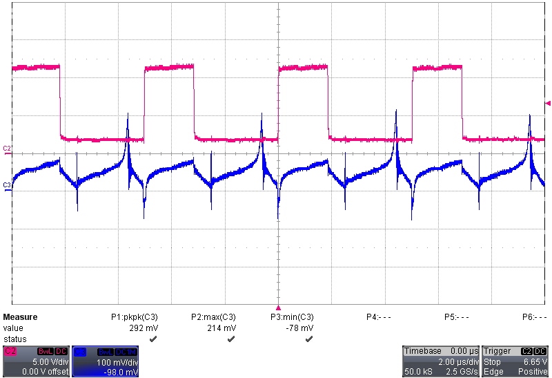

  • Ch2: DPWM0A Ch3: Current signal @EP2
             the control loop is only voltage. you can see the current signal maybe go to saturation status. Then i use the register of cycle adjust to add 10ns duty for calibrate the current signal . It change normal but 10ns is too small . So the voltage loop control is not good for our module.
  • Ch1: Current signal @ EP2 ch3: DPWM0A Ch4:DPWM1A
    I get the wave in PCM mode. Although you said that the shake is 50ns, it is ok . but the output riapple will out of the spec. And it have some anomalous concussion. It case the output riapple to became more bad. we want to search the reason, so do some test. By this time, do not know the shake come from voltage loop or current loop.
