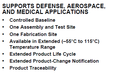

    Thanks , Weidong,I found there is a UCD9222-EP which is p2p compatible with UCD9222. What's the difference between this two components?Is there any need to modify the hardware to use UCD9222-EP ?
    Why TI recommended TPS53659 instead of UCD9222-EP?
    Nick
  • EP is a designation for Enhanced Product.  Typically, this means that the device has to meet additional requirements for a particular end applicxation, in this case the datasheet lists that the device is suitable for certain defense/aerospace/medical applications.  In particular, this device has been approved for use over -55 to 115 C temperature range vs the -40 to 125 C temperature range of the standard part.
    The silicon itself should be identical.
    The TPS53659 is a somewhat newer device and likely has better transient performance capabilities over the UCD9222 but requires an additional device like the LM10011 to implement AVS, the UCD9222 can implement AVS natively but some folks find it more difficult to work with given the flexibility of the digital implementation.  Either should be capable of powering the C6657 application.
