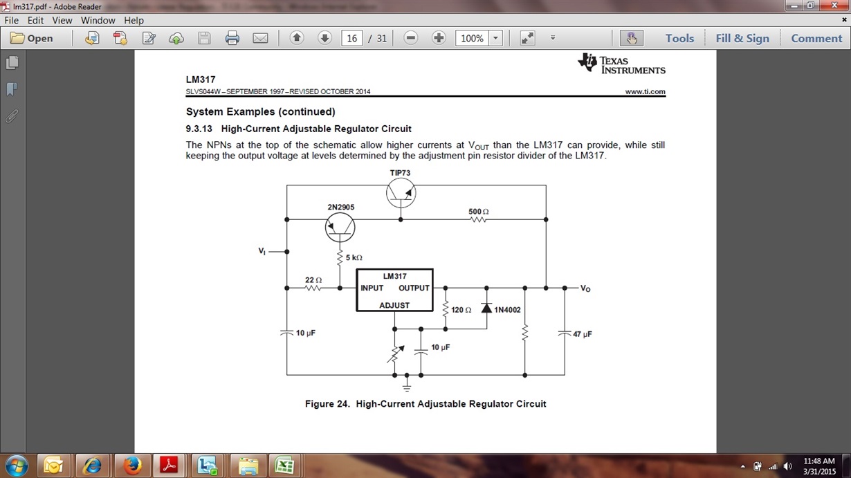

I having project to build Power Supply Adjustable with single output. with spesification:
- Max Output 35 Vdc (Adjustable) and Maximum Current is 10 Amp.
any suggetion which regulator can i use, and mybe you can share for recomended electrical drawing for my project.
Until now, i try using for Regulator LM 317 and refer by data sheet, i try to follow this schematic: (see picture below)
But The Problem is for Transistor TIP 73 already absolute or can't find in the market. and i try for replacement TIP 74 also can't find in the market, so need your help for sugetion Which part can be replace TIP 73. and easy to get in the market.
