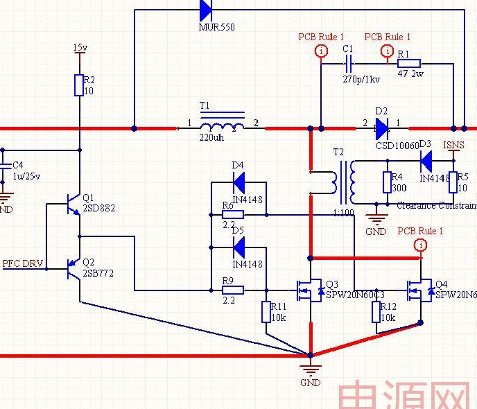

UCC28180: could i replace the Rsense with a current transformer so that i can improve the efficient in high load.
Part Number: UCC28180
 I have replace the Rsense  with a current transformer as UP SCH
but the PF is low and input current waveform is so bad。
    The current transformer in your circuit is only sensing the MOSFET drain curremt.
    You need to sense the inductor current, which is the sum of the MOSFET current and the boost diode current.
    So you need to add another current transformer on the diode path. Then add the outputs of the current transformers with isolating diodes.
    Alternatively you can use one dual primary current transformer with one primary loop on the MOSFET drain and the other primary loop on the anode of the BOOST diode

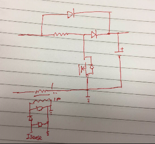

  •  so if  i change the location of the current transformer like up SCH,may it works?
    or can you post a applicationed case to me .
  • A current transformer will not work in the location shown in your sketch because  there is a large DC  component here.

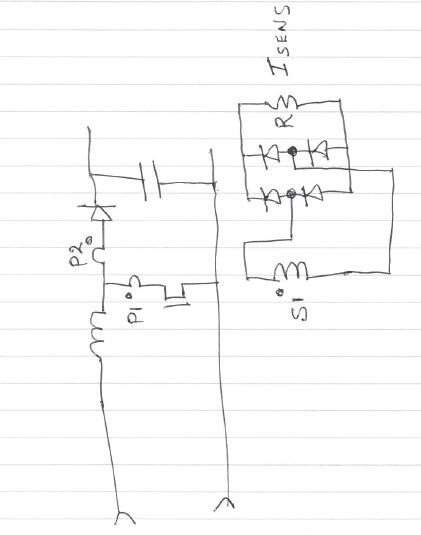

    You can try the circuit shown above.
    The current transformer has a dual primary winding. One primary measured the drain current and the other primary measures the diode current.
    Since the primaries are connected up out of phase the average magnetic flux is zero and the transformer will not saturate.
    A bridge rectifier on the secondary will measure the full inductor current as required.
