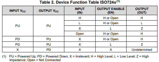

  • Hello Kobayashi-san,
    I have investigated this problem with Richard, and I can explain why there is actually a clear reason to drop VBIAS2 first.
    UCC27714 inputs are driven by an ISO7240M digital isolator. Please look at Table 2 in the ISO7240M datasheet. I have copied the table below.
    If VBIAS (the input VCC,) is powered down, but VBIAS2 remains powered up, the output state defaults to high because the output enable pin (EN) is tied to the output supply pin. This will cause all inputs to both UCC27714 to become high. UCC27714 allows both HO and LO high simultaneously, and this can lead to shoot-through or damage to the EVM.
    If VBIAS2 (the output VCC) is powered down, the UCC27714 devices will be deactivated correctly along with the ISO7240M. Current flow through the primary current sense transformer will be reduced to 0, and the controller CS pin voltage will decrease to 0V. The synchronous rectification from UCC27524A will be stopped by the UCC28950 once the voltage at the CS pin reduces below VDCM, as per Figure 47 of the UCC28950 datasheet. VDCM is approximately 0.39V.
    To summarize: The correct sequence to power down should be VBIAS2 -> VBIAS -> VIN. Also, the correct sequence to power up should be VIN -> VBIAS -> VBIAS2, to avoid the same problem with ISO7240M output state defaulting to high.
    As an additional precaution, I recommend installing a switch on the SS/EN pin to GND for the UCC28950. When the SS/EN pin is shorted to ground, the controller deactivates. By keeping the SS/EN pin shorted to ground until the correct sequence to power up has been completed, the controller will begin the soft start sequence only after the UCC27714 drivers are ready to receive inputs.
    Thank you for bringing your issues with power sequencing to our attention. We will ensure that the user's guide is updated with this information.
    The UCC28950 should soft start the output rail. There are two ways this can be achieved:
    1. Short SS/EN pin to GND until all power sequencing is complete (Vin → Vbias → Vbias2). Release SS/EN short to GND to start the controller.
    2. Replace the ISO7240M with a different digital isolator, such as ISO7640FM, that has default LOW output. Then, the power sequence becomes Vin → Vbias2 → Vbias. This does not require SS/EN pin to be shorted to ground, since Vbias is applied last. Furthermore, when using ISO7640FM or equivalent, Vbias may be removed first to disable the controller.
