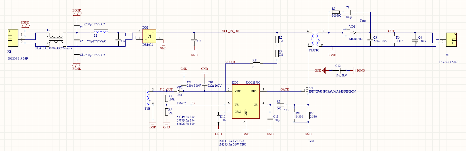

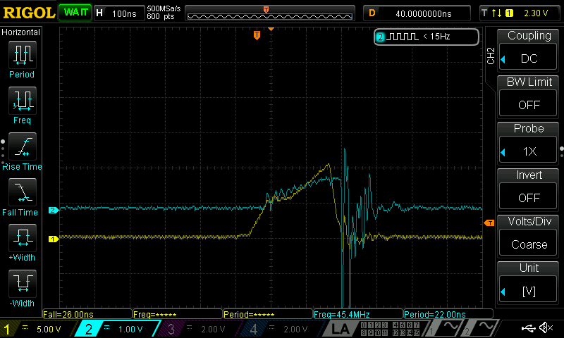

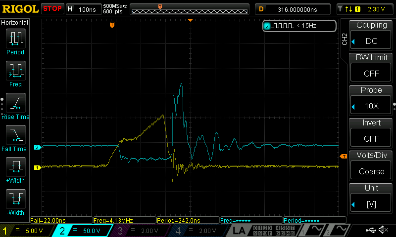

I made CC power supply using UCC28700 (for input range 90-285VAC) and it can't start. Desired characteristics: output current (CC) 0.7A, output voltage is around 90V.  IC generates the series of 3 pulses on DRV pin and nothing alse. Transformer based on PQ26/20 core. I tried 2 configurations: (Pri:Aux:Sec) 1) 28:7:36 and 2)30:5:33(Actual).
DRV (1) and AUX (2):
FET source pin:
Schematic:
