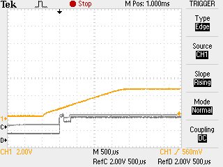

  • In the first image above waveform A is VBOOT, B is VMAIN, C is VGH, D is VGL, and 1 is VIN.  The images are broken up so I apologize that the data has to be looked at in pieces.
    It looks like the power up sequence is going on before Vin is actually stable.  I am assuming I need to control the RUN and EN pins and toggle them once the power supply is stable?

  • Hi David, Hi Mike,
    I assume you both are working on the same schematic?!
    I am a bit confused how VGL (VGH) behaves. How is it possible that before even VIN starts VGL has already 500mV? Additionally there is no way that VGL can jump that fast up to ~VMAIN except the path via Resistances (R146+R147~340kOhm) and the output cap (100nF), which would charge VGL at a time constant of ~34ms. But in this case it jumps as fast as VMAIN <100us.
    Is VMAIN/VGL/VGH terminated with some load? If yes, does that start-up behavior appear when the load is not connected?
    The sequence is actually correct, VMAIN starts to ramp if EN=~1.21V, and in your case EN=VIN, which is ok. Same applies to VBOOT and the "Enable"-Pin RUN. Is it possible to zoom in at the ramp-area of VMAIN-VGL-VGH? How does the Switching- Node SWN behave, it might be helpful if you could at this plot as well.

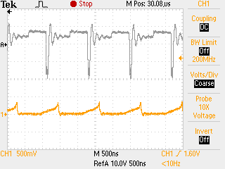

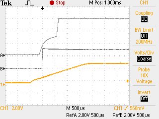

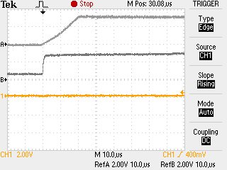

  • Ilona,
    Yes we are working off the same schematic.  I took some more images below.  Just as a note the previous images were taken with a TFT LCD attached while the ones below have no load at all.  There is a large operational difference in regards to VGH with and without the LCD attached.
    A = VMAIN
    B = VGL
    1 = VGH
    No load attached and all signals are triggered at power up of system
    A = SWN
    1 = SWP
    No load attached please note that both images were taken at different amplitude scales.

    The only possibility when VGL can go positive is that the rectifier diode is mounted in the wrong direction (see scope), can you check if your diode is mounted correctly?
    Ilona
  • Ilona,
    Very helpful! That did the trick. The decal for the diode was incorrect as I thought a different part was installed that had a reversed polarity. Swapped the part around and the whole circuit worked perfectly. Thanks again for the help!
    Dave
