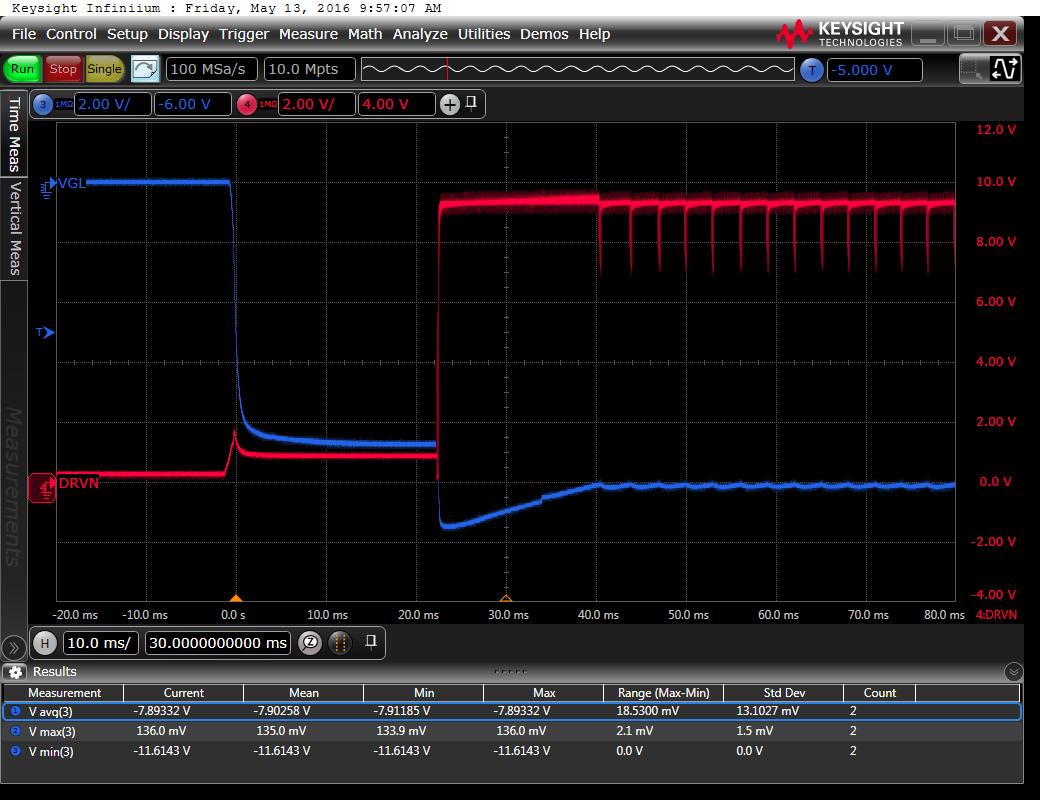

  • Hello Ilona,
    I come back to you about the VGL voltage power up. At start up, we get an undershoot on the VGL signal and it reach the -10V target. It append when the DVRN pin is driving.
    I try with the 1Uf and 2uF output capacitors and nothing change.
    Here a screenshot of the two signals:
    We did the test with the LCD screen plugged and unplugged. There are no differences on the signals.
    Is there a way tu cut this undershoot?
    Thank you
    Sebastien
