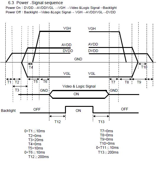

Hello Team,
Could you assist me to achieve the timing requirement as shown in the attached file for a 10.1" LCD using TPS65150 IC.

  • Hello Nishmitha,
    I reviewed TPS65150 power sequencing and your LCD panel timing diagram and below is what I have been able to infer.
    T1 -- is independent of TPS65150 as DVDD will be provided by your system
    T2 & T3 -- is independent of TPS65150 as your system will provide the input voltage to TPS65150 and should time it such that power to TPS65150 is not provided until DVDD has been stable for atleast 20ms.
    T4 & T5 -- choose Cdly1 of very small value (like 10pf) and Cdly2 of ~47nF to provide a delay ~11ms for T5. Please see section 7.3.4 on page 17 of datasheet for further details on calculating delay times.
    T6 -- is independent of TPS65150 as video output will be controlled by TCON/your system.
    T7 & T8 & T9 & T10 --- are independent of TPS65150 as input supply to TPS65150 and DVDD supply will be controlled by your system.
    T11 -- I do not know what this time is as I could not find it in the timing diagram.
    T12 &T13 -- are independent of TPS65150 and will controlled by back light controller.

  • Hello Liaqat,
    Thank you for the assist.
    I have one more query regarding the timing setting.
    1) Is it possible to achieve VGH voltage before VGL .
    2) Is it possible to set DLYI pin delay to 0ms to achieve AVDD and VGH at the same time. If its possible what would be the possible connectioncat DLY1.
    Thanks and regards,
    Nishmitha
  • Hello Nishmitha,
    It is not possible to achieve VGH before VGL as VGH does not start until VGL is valid.
    DLY1 delay is between AVDD valid to when VGL starts up. So DLY1 does not control the delay between AVDD and VGH. As I mentioned above, VGH will not start until VGL is valid.
