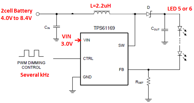

Hi Team,
Our customer would like to use the following conditions.
[Conditions]
-Vin=3.0V
-2cell Battery = 4.0V to 8.4V
-Iout= around 20mA
-Vout=around 17.5V to 21V (LED is 5 or 6.)
-Dimming frequency is several kHz
-Inductor is 2.2uH (This value is our customer demand. )
Therefore, we would like to ask you a question.
[Q1]
Our customer would like to separate “VIN” and " regulation voltage".
Because, they would like to use the 2cell Battery(4.0V to 8.4V).
Could you please let us know if you have any concern for this usage?
[Q2]
If this usage is allowed, could you please let us know the startup sequence?
Should I apply "2cell Battery" first?
[Q3]
I understand that the recommended value of inductor is 4.7uH to 10uH.
However, our customer would like to use 2.2uH.
Kanemaru
