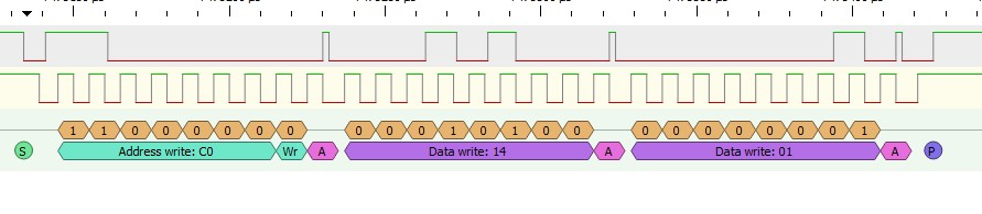

we have a simple board with only 2 x TLC59116 on the I2C but. One with HW address selecting bits to 0 and the second to 1.
I send the code below (only few lines in main() but the LED does not turn on. The I2C communication on the scope is correct, I see all 3 bytes including the ACK for each byte so the device is receiving the data.
Can you please let me know:
- am I missing something
- do I need to run some other commands before or after in order to turn the LEDs on?
- can you please write a snipped of pseudo-code with the correct bytes/commands sequence
Many thanks
Rick
        //compose message
        i2cData[0] = 0xC0;  // I2C slave address (including A0 HW-configured) + R/_W bit
        i2cData[1] = 0x14;  // Control register
        i2cData[2] = 0x01;  // Set LED fully on
        i2cDataSz = 3;      // message size
        I2CState = I2C_SendMessage(I2C_2, i2cData, i2cDataSz);

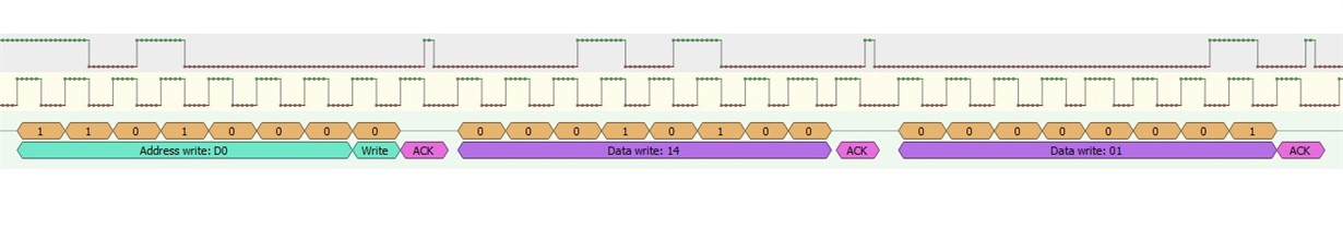

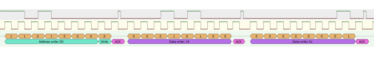

  • Hi Kenneth,
    today has passed with no reply to my post and this is now extremely urgent, can you please reply asap (very kindly asked!! :) ) to my post to your message yesterday.
    I tried the 0x68 and it does not work either.
    Please see attached waveform of the protocol analyser showing both 0x68 (0xD0 shifted) AND 0xC0 (0x60 shifted).
    As you can see the communication is working so no issues there, the IC sends ACK tot he full message. It is just a matter of knowing the exact sequence of commands/data to write to a fresh IC from the production line to get it up and running. Which is all I was asking in the first place, just a pseudo code list of codes and operations to get to the first LED to turn on, after that I can work all the rest out myself.

  • Hi, Rick,
    The code is correct and it's written based on a former code so some info may not remove.
    Anyway, let me give you the full steps for achieving this by using Allcall address for a quick check and you can also get it through the datasheet:
    1. Send MODE1 (Addr = 00h) with data 01h to select All Call address;
    2. Send MODE2 (Addr = 01h) with 00h;
    3. Send Addr = 02h to Addr = 11h with FFh to set PWM0-PWM15;
    4. Set Addr = 12h for FFh to set GRPPWM;
    5. Set Addr = 13h for 3Fh, just for example;
    6. Set Addr = 14h to Addr = 17h to FFh;
    7. Set Addr = 1Ch to F8h.
    This should turn on all your LEDs.

  • Thank you Kenneth,
    Now it seems to work. :)
    The only thing is that it works only if I call it with 0x60 address and not with the All Call. I am not clear as to how the All Call works. I tried googling it and also looked in details in the datasheet but can only find a brief unclear explanation as to how it works and how to set it up.
