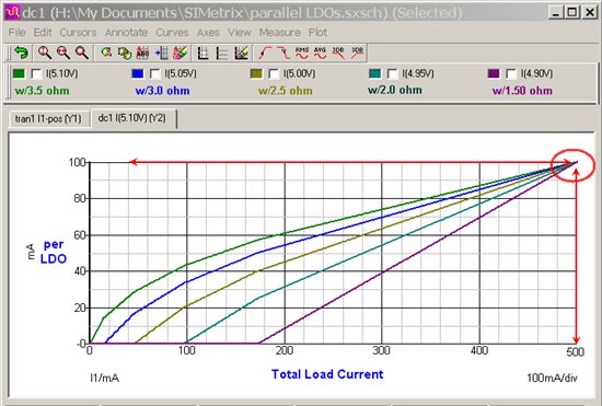

  • For example, if you have five random LM2940-5.0 devices with no load output voltages of 4.90V, 4.95V. 5.00V, 5.05V, and 5.10V (i.e. 5V +/-2%) and each output has a 1 Ohm series resistor for ballast, the intial load current would all be from the 5.10V output until there was enough IR loss across the ballast resistor to engage the next lowest output (5.05V).
    With the 5 output voltages listed above, and a 1 Ohm ballast resistor on each output, at 500 mA load current the individual regulators will supply as follows:
    5.10V = 199.7mA (40%) ; 5.05V =149.8mA (30%) ; 5.00V= 100mA (20%) ; 4.95V = 50.1mA (10%) ; 4.90V = 0.3mA (~0%) ; with the voltage at the load = 4.89V
    With the 5 output voltages listed above, and a 2 Ohm ballast resistor on each output, at 500 mA load current the individual regulators will supply as follows:
    5.10V = 150mA (30%) ; 5.05V = 125mA (25%) ; 5.00V= 100mA (20%) ; 4.95V = 75mA (15%) ; 4.90V =  50mA (10%) ; with the voltage at the load = 4.79V
    The secrect is to get very closely matched output voltages among the 5 regulators.

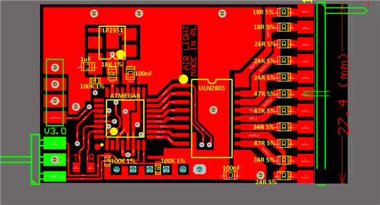

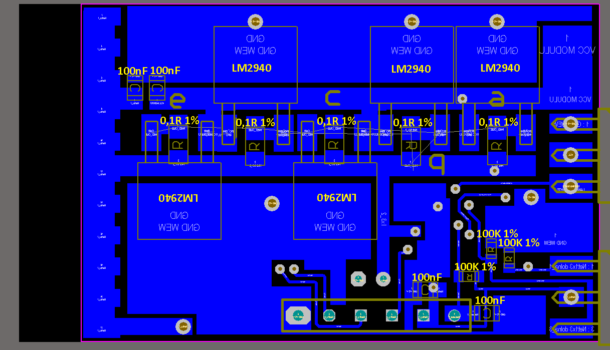

    Yet, 5V is essential. Project drives LED lamps which works around 2,7 and 3,5V. But the LED are driven by ULN2803 which generate quite big voltage drop around 1-1,5V.

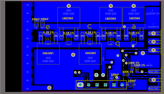

    PCB is small. 40 x 27mm with TOP and BOTTOM layer. Cooper thickness is 70um. PCB thsickness is 2mm.
    I have made as large poles as I could - LM's are TO252.
    Please take a look. LM's are all on the BOTTOM side - blue image. During load test on all LM's were glued radiator - flat alu, 2mm thick (40x25mm).

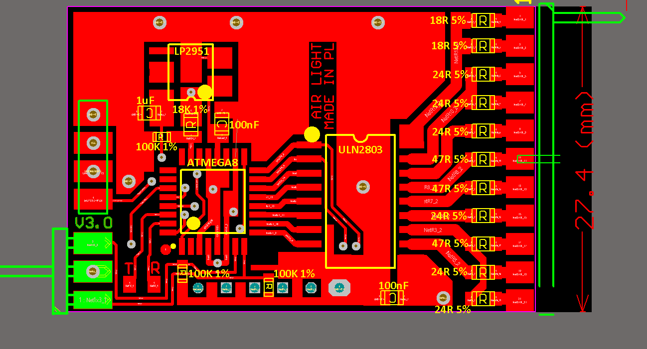

    On the TOP layer are micro controller and darlington driver, plus some RLC components.
    When the stabilisers reaches 110 C deg (despite of radiator) those elements have aproxx. 80 C deg.
    The load test shows that individual temperatures of LM's were from 80 to 110 C deg (therein two of them were 110 and 100-109)
    Tomorrow I will try the same load test but with differ radiator with ribs to check if it could help to dissipate heat.
    Unfortunately the major heat is transferred into the PCB since the TO252 is SMD mounting element.

  • You said earlier "... LM's are TO252....", is that actually TO-263 (i.e. LM2940S or LM2940CS)?
    Total dissipation: Pdiss= ((21V - 5V) * 260mA) = 4.16W.
    Guessing that there is some modest load current sharing so that the LDO with highest output voltage supplies 33% of the load current at start-up then that one device is dissipating: ((21V-5V) * 87mA) = 1.4W.
    If the thermal resistance (Theta(j-a)) of your PCB is at no more than 80C/W then the junction temperature will want to rise above ambient: Trise = (1.4W * (80C/W)) = 112C.
    If ambient temperature (Ta) is near 25C, then that puts junction temperature :Tj = (Ta + (Pdiss * Theta(j-a))= (25C + 112C)= 137C.
    That's getting close, so some small variation could push it to the thermal limit. Heat propagating throught the copper from an adjacent warm LDO ~might~ be enough.
    Temperature measured externally will always be lower than the junction temperature at the middle of the silicon die.
    Reaching a constant elevated case/tab temperature on several of the LDO's could certainly be an indication that the thermal limiting temperature has been reached.
    What would happen, in theory, is that one LDO starts off (at power on) carrying a greater percentage of the load current than the rest, after a few seconds it reaches thermal limiting and starts to reduce it's output current, the output voltage starts to fall, the next lower output voltage picks up some more of the load current, after a short time the second LDO heats up and reaches thermal limiting and starts to reduce it's output current, and so on. Chain reaction.
    You could monitor the tab temperature of each of the LDO's as you raise the input voltage in, for instance, 1V increments. You will know that it's thermal limiting if a second or third device starts getting hotter after one device has hit the 110C barrier. Current has transferred to the other device(s) increasing their  dissipation.
    One way to monitor this is monitor the output voltage at the OUT terminals (before ballast resistor), output current and voltage will fall enough that device dissipation remains constant. How much the voltage falls all depends on how close the next lowest LOD output voltage is. Or, measure the voltage across the ballast resistor to see if the output current is dropping.

    My test on few PCBs shows that only sometimes second LM reach temperatures around 100 C. Typically is 80-90 C. Others obviously much less.
    What it mean after your last post - my conclusion is that first LM reach it's limit, and another one take some of first load and heats up depending on the output voltage.
    If the second gets 100 - it means that output V value was close to to the first LM.
    I will make the measurements with the dropping Voltages during heating up as you post above.
    I was wondering. Since I can not replace all of the ballast resistors, maybe I could replace just only one or two on each PCB.
    For ex. after figured out the output V of each LM I will mark two of them with the highest V output. First that will take major load (and heat up the most) and second just after the first.
    Then I would replace their ballast resistors with higher values respectively to make the current be shared better.
    How higher the values should be? I don't know. And that is I thought maybe you would have some idea how calculate them.
    I know its doable, but I know your knowledge and experience make me convinced that the formula won't have mistakes.
    Despite the calculations I would make some practical tests.
    if off course this is a good way.

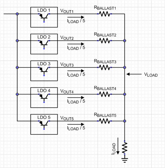

  • When you measured current, at what point in the circuit was that at?
    For the customized, per LDO, ballast resistor calculations ...
    We  need to know the total load current that needs to be divided up. and we would need to know Vout for each of the LDO's under some defined condition (i.e Vin=12V and Iout= Iload/n). This should be some operating 'sweet spot' to target where we want load current to be very nearly evenly balanced. Then need to determine a target voltage at the load that is at least 100mV lower than the lowest LDO output voltage. Need to keep in mind that load current at ideal 5.00V will probably be different that load current at 4.50V or 4,75V, so there might be some trial-and-error involved here.
    For this exercise we can say that the lowest LDO Vout is 4.850V, so the target load voltage (Vload) will be 4.750V
    Then go through each LDO,1 thru n, and calculate the ballast resistor value for that individual LDO ...
      Rballast1 = ( (Vout1 - Vload) / (Iload / n) )
      Rballast2 = ( (Vout2 - Vload) / (Iload / n) )
       Rballastn = ( (Voutn - Vload) / (Iload / n) )
    You will probably end up with some odd resistor values and it may help to tweak the target load voltage a few millivolts higher (lower R values, less accurate sharing), or a few 10's of millivolts lower (larger R values, more accurate sharing) to get values that are close to standard values. This is a spreadsheet project.
    If we go back to those values I threw out for an earlier example : Vout1=4.90V, Vout2=4.95V. Vout3=5.00V, Vout4=5.05V, Vout5=5.10V, Load current is 500mA, and the targeted load voltage is 4.75V, then
       Rballast1 = ( (4.900V - 4.750V) / (500mA / 5) ) = (150mV / 100mA) = 1.50 ohm
       Rballast2 = ( (4.950V - 4.750V) / (500mA / 5) ) = (200mV / 100mA) = 2.00 ohm
       Rballast3 = ( (5.000V - 4.750V) / (500mA / 5) ) = (250mV / 100mA) = 2.50 ohm
       Rballast4 = ( (5.050V - 4.750V) / (500mA / 5) ) = (300mA / 100mA) = 3.00 ohm
       Rballast5 = ( (5.100V - 4.750V) / (500mA / 5) ) = (350mA / 100mA) = 3.50 ohm

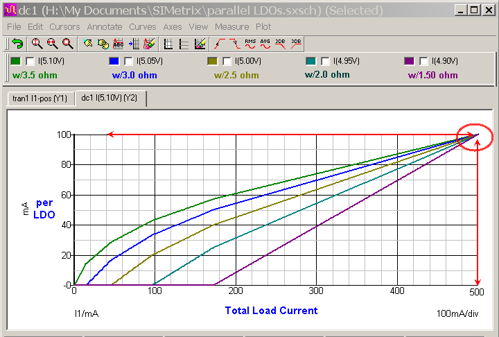

    SPICE shows that at the target total load current of 500mA the load current is shared evenly at 100mA per LDO.
    At the end of all this it is unlikely that you will have everything fall into exact standard values so you will need to make some judgment calls on what you want to trade off or how you will make adjustments. All in all, this does not lend itself well to any kind of volume production.
    Longer term, I would suggest that you consider modifications to the PCB copper area to improve heat dissipation from the LDO packages through the PCB. I would suggest multi-layer PCB with the inner layer connected via multiple thermal vias directly under the TABs of the packages. On the existing layout I would sugsest vias to move heat to the copper area on the other side of the board. I doubt that there would be more than a small percentage improvement from increasing the existing copper thickness from 70 microns to 105 microns.

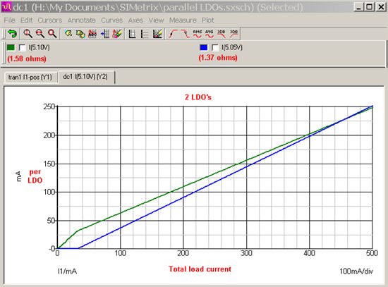

    OK, first back to your previous post.
    Load was measured on power supply, so before LMs.

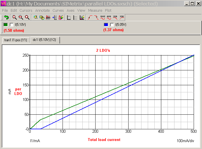

     For the first test I will try to replace only two resistor to make better sharing between two closest stabilizers.
    I want to make this intentionally to find out if heat spread on to two LM will lower each one below for ex. 100 deg.
    Other ballast resistors stays 0,1 ohm, so their current share is negligible .
    For this time I will use default Vout you undertake previously. And lets try to share the current between those two LM:
    In = 0,44/2 = ~ 220mA
    Rballast1 = ( (5.050V - 4.750V) / (220mA ) = (300 / 220mA) = 1,36 ohm
    Rballast2 = ( (5.100V - 4.750V) / (220mA ) = (350 / 220mA) = 1,59 ohm
    It seems like the problem is that resistor values are not much different from each other.
    And it's impossible to buy values like calculated above.

  • "... the problem is that resistor values are not much different from each other..."
    And the difference in the output voltage here is only 0.050V. As the difference between the reg output voltages decreases the R values get closer.
    " ... And it's impossible to buy values like calculated above..."
    Yes, getting exact x.xxx values might be very-very difficult and expensive,
    Getting 'close enough' is not impossible ...
          Closest standard 1% (E-96) value to 1.36 ohms would be: 1.37 ohms
          Closest standard 1% (E-96) value to 1.59 ohms would be: 1.58 ohms
    For 1.37 ohms in 1206 case (1/4W) see
       Vishay-Dale # CRCW12061R37FKEA, or CRCW12061R37FNEA
       Yageo # RC1206FR-071R37L
    and for 1.58 ohms in 1206 case (1/4W) see
       Vishay-Dale # CRCW12061R58FKEA, or CRCW12061R58FNEA
       Yageo # RC1206FR-071R58L
    Or ... you get ~creative~ and perhaps stack some R's in parallel to get close enough to needed values.
    Or ... you recalculate at a slightly different (lower) load voltage to see if you can get closer to standard values
    Or ... you recalculate at a slightly different (lower) current to see if you can get closer to standard values
    Or ... a little of both
    Or ... you say "238mA per LDO is 'close enough' to 220mA" ...
