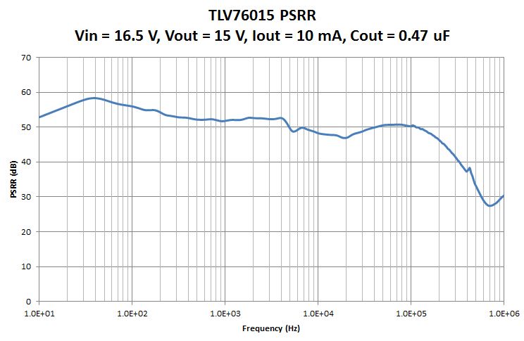

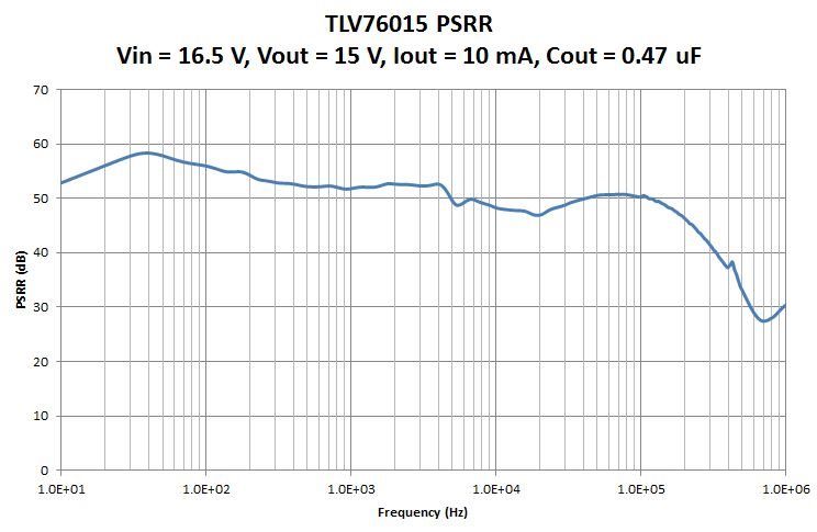

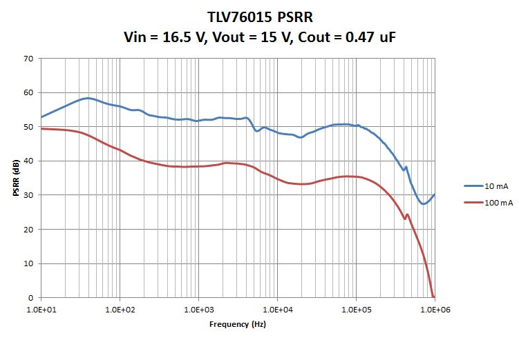

The customer wants a PSRR value under the following conditions.
VIN=VOUT+1.5V
VOUT=15V
IOUT=10mA
Is it possible to confirm?

Hi T Kishi,
PSRR is affected by various application specific conditions such as headroom, output voltage, and output current. Unfortunately your application conditions vary enough from the figures provided in the datasheet that the figures in the datasheet would not be a great reference for you.
Here are a couple of application notes that discuss techniques for measuring PSRR:
I was able to complete taking PSRR over your application conditions.
