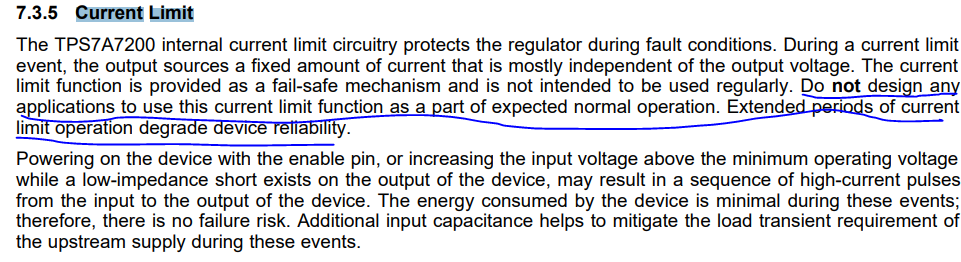

Hi Kevin,
Current limit is a protected feature and application is not expected to have device running at current limit. We don't have a maximum spec for the Ilim. It's normal to measure a value of 3.28A for a typical spec at 3.1A Ilim.
Please see the discussion on the current limit in application section:
