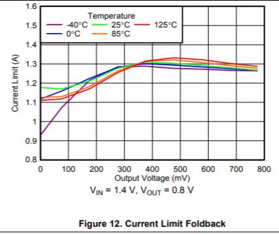

May I know when can find TPS7A90 Thermal Curve with Load Current from 0mA~500mA?
Thanks.
Eric
Thanks.
Eric
Hi Eric,
In order to know the thermal performance, you will need to know the Vin and Vout of the device while operating as well. Once you have the two values, you can use the equation provided in the datasheet to generate your own curves. Here is the equation. If you have any questions to apply it for your application, please let me know.
Jason Song
