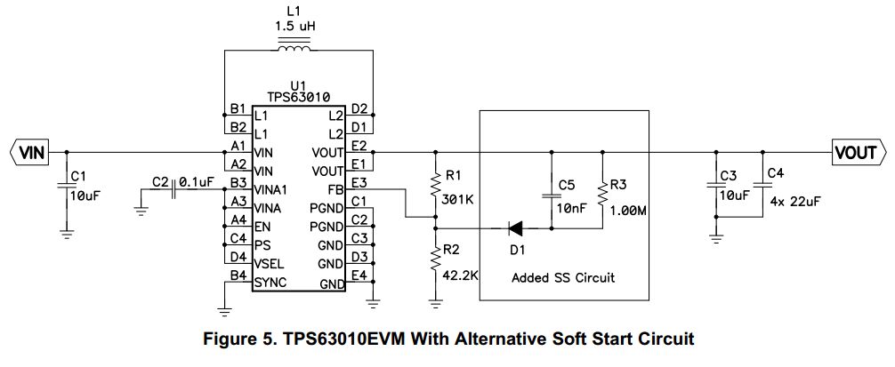

TPS63010 / Extending soft start time
Other Parts Discussed in Thread: TPS63050
Hi All,
I'd like to know the calculus equation to estimate the extended soft start time by adding RC and diode as Fig.5 in following Application Report. It will be appreciate if you have other app note that state calculus equation for this.
http://www.ti.com.cn/cn/lit/an/slva553/slva553.pdf
