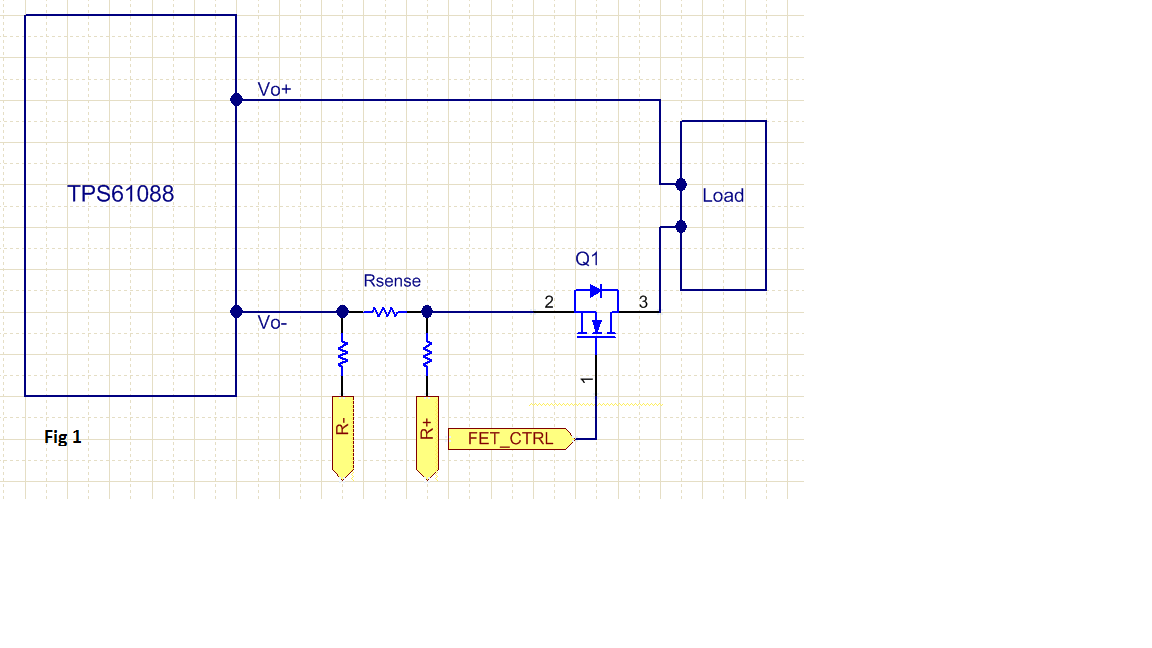

  • Hi Leonard,
    I also post my reply here in case more person can see the answer:
    TPS61088 doesn’t has load disconnect function. The customer need to add an extra MOSFET at the output side. This MOSFET can be used for both load disconnect and short circuit function. Please check the below picture:
    1. when output is shorted, the ouput voltage will be low, and the output current will be very high.  Suggest the customer to detect the output voltage or the output current (use a sense resistor Rsense) by a MCU, if the output voltage is lower than a certain value or the output current is higher than a certain value,  turn-off Q1.
    2. Enable/disable the MOSFET and the TPS61088 at the same time to realize the load disconnect function.
    Thanks!
    Helen
  • Here's the simplified schematic:
  • If we don't want to monitor the current, we can eliminate Rsense, and simply disconnect the RTN of the load; the TPS61088 already has a ILimit function.  However, I'm wondering how practical this is to open the GND path, as most GND connections are to a GND plane, plus the TPS61088 has a GND power pad.
    Would it not be easier to put the FET directly at the VOUT pin?  Even so, at high currents, this has to feed a large power plane.
    The other aspect of this suggested approach is the load is not a single device, it is dozens of other ICs, maybe an FPGA or Processor, so it becomes rather impractical to implement the FET in the GND path.
    Do we have another approach that would isolate the VOUT path?
    ~Leonard
  • Then you can add a PMOS at VOUT+.  I reply you in the email :)
