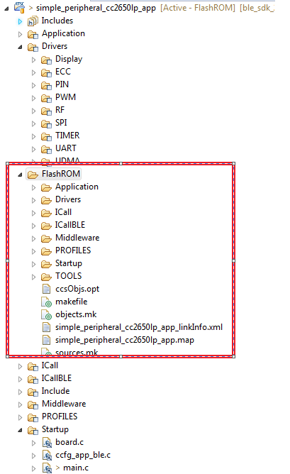

  • I tried, and I get errors when I build.
    Here is the interesting part of console :
    undefined first referenced
    symbol in file
    ti_sysbios_family_arm_lm4_Timer_getAvailMask__E C:/ti/tirtos_cc13xx_cc26xx_2_18_00_03/products/tidrivers_cc13xx_cc26xx_2_16_01_13/packages/ti/drivers/lib/drivers_cc26xxware.aem3<PWMTimerCC26XX.oem3>
    ti_sysbios_family_arm_lm4_Timer_setAvailMask__E C:/ti/tirtos_cc13xx_cc26xx_2_18_00_03/products/tidrivers_cc13xx_cc26xx_2_16_01_13/packages/ti/drivers/lib/drivers_cc26xxware.aem3<PWMTimerCC26XX.oem3>
    error #10234-D: unresolved symbols remain
    error #10010: errors encountered during linking; "LED_simple_peripheral_cc2650lp_app.out" not built
    gmake: *** [LED_simple_peripheral_cc2650lp_app.out] Error 1
    >> Compilation failure
    makefile:194: recipe for target 'LED_simple_peripheral_cc2650lp_app.out' failed
    gmake: Target 'all' not remade because of errors.
    **** Build Finished ****
    What do you think about that ?

    Into PWMTimerCC26XX.c I commented the PWM_FxnTable because I got an error about redefinitions of this table.
  • To be more exhaustive, I did the following into "ti/drivers" :
    - I added folders from RTOS 2.20 to 2.18 : adc, adcbuf, timer
    - I replaced the old folder pwm with the one included in RTOS 2.2, and I commented PWM_fxnTable into PWMTimerCC26XX.c like I said before
    - I added/changed files from RTOS 2.20 to 2.18 : ADC.c, ADC.h, ADCBuf.c, ADCBuf.h, PWM.c, PWM.h
    So, what's wrong ?

    You should not need to do that. Can you revert the changes and try delete the FlashROM folder and rebuild it.
  • Thank you, it's ok now
