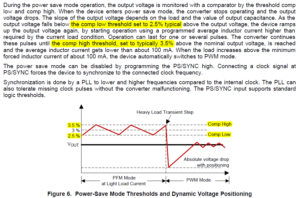

Hi Team,
Our customer would like to know the maximum value of the comp high threshold and the minimum value of the comp low threshold.
Because, they would like to calculate the accuracy of VOUT at the power save mode.
I understand that the 3.5% is typical value of the comp high and 2.5% is typical value of the comp low.
Could you please let us know if you have any information?

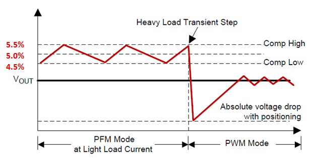

And, I have one more question.
If VFB is 525mV (500mV * 105%) at the power save mode, max value of VOUT is (VOUT*105.5%).
Is my understanding correct?
