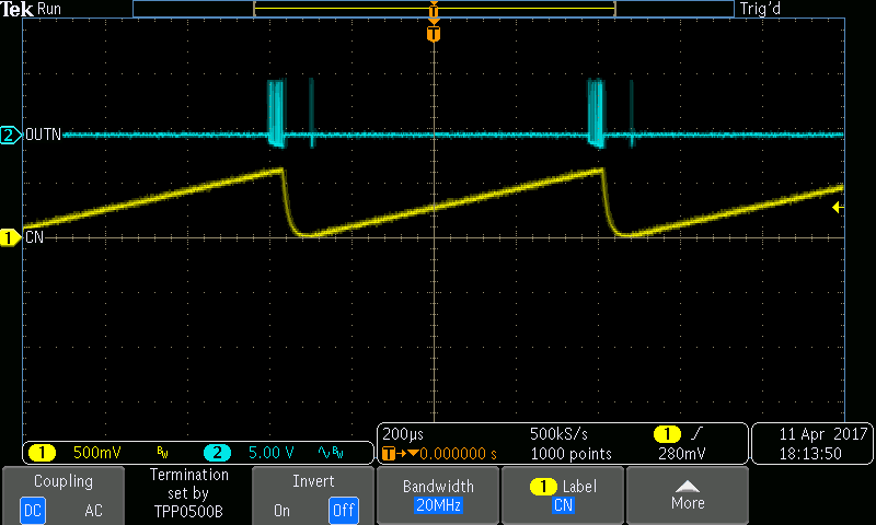

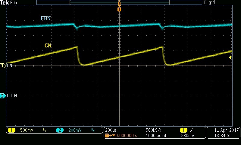

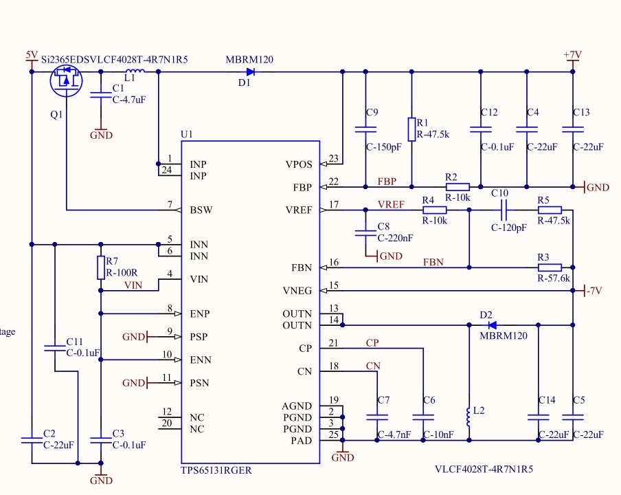

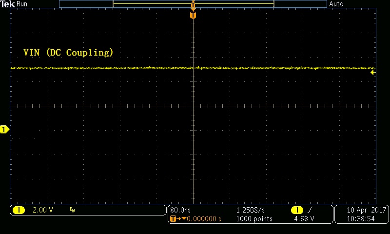

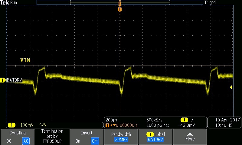

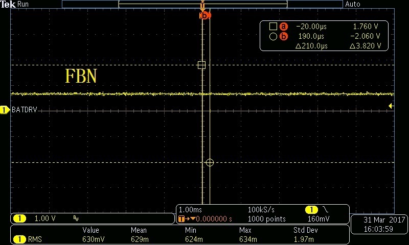

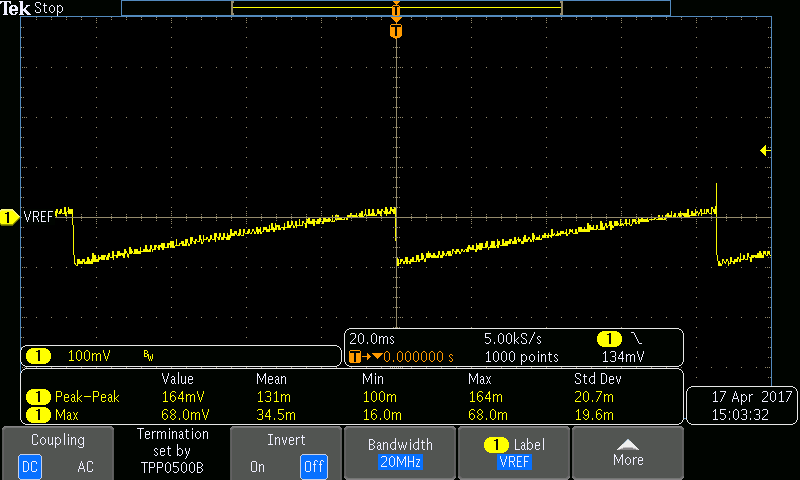

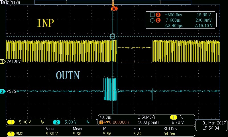

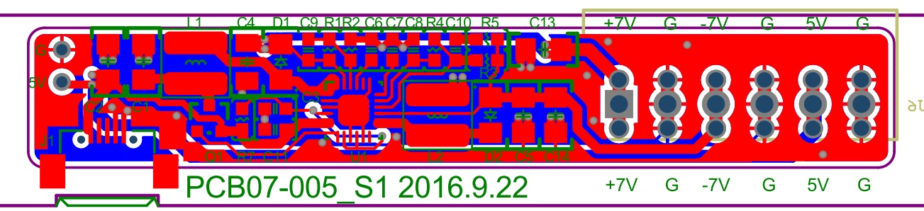

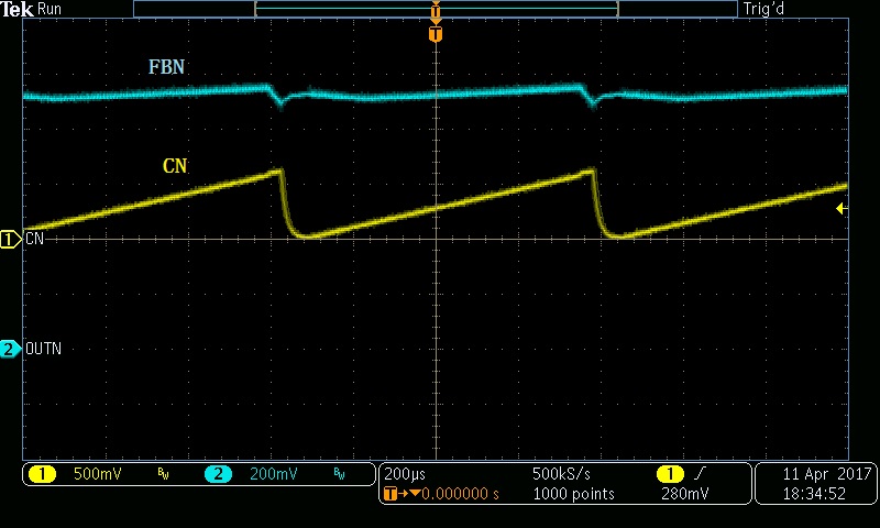

My TPS65131 in configuration: +5VIN, +/-7Vout cannot work properly. The ckt can keep regulated +/-7V outputs without load. While the negative output dropped to -2.5V once it is loaded with only +/-18mA (390ohn resistor load), and there is no problem with +7V output. Strangely the problem may disappear if the input voltage dropped to 3.3V. I observed the voltage on pins VREF (PIN 17), FBN (PIN 16). VREF is 1.216V, FBN is consistantly a positive voltage. Bellow is the schematic ckt:
What is the potential problem do you think?
