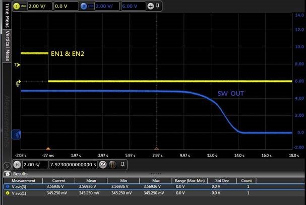

hi sir:
Per our measurement, the V7V will drop to 0V when the Buck1 Enable is pulled low (disabled).
Once the V7V drops to 0V, the output power through the switch will be cut off. Is it the expected
behavior of TPS65283?
hi sir:
hi sir:
if pull low ENx low that 0.4V will turn off LDO and cause the SW_out off?? customer test waveform as bolew:
it's correct? There are other possible to cause SW_out off??
I check EVM again.
When EN1 and EN2=low, the V7V will be pull low, LDO shut down, the POWER SWITCH is turn off, so the SW_out is pull low too.
