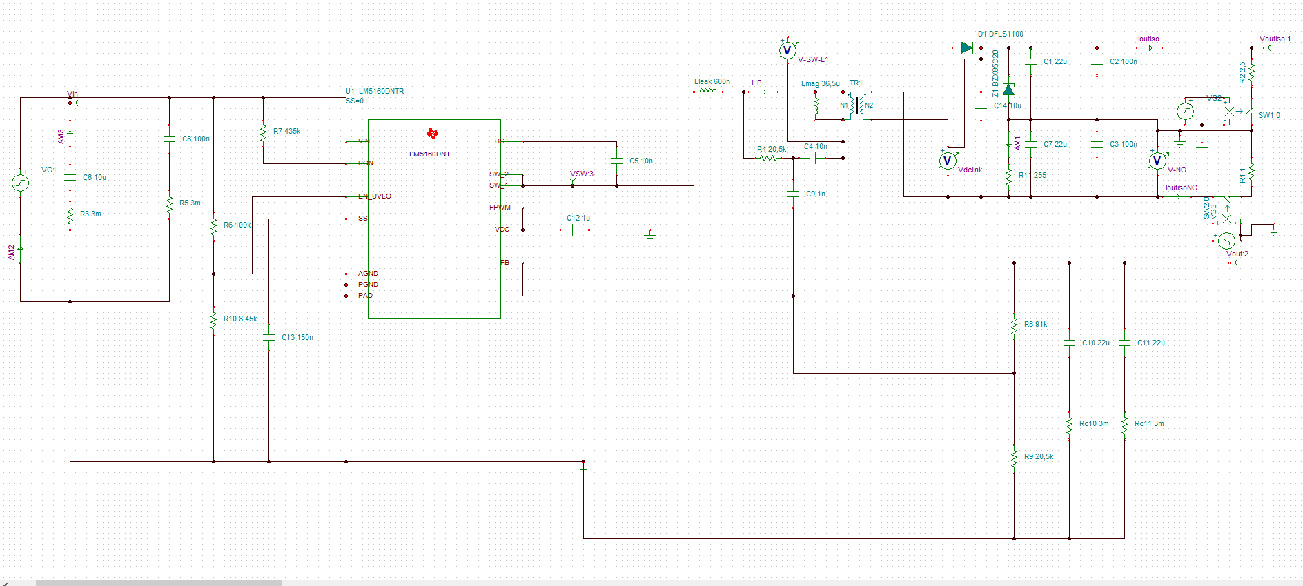

Hello everyone,
I am using the LM5160  to create 20V and -5V isolated supply.
Vin=24V,
Soft start=30ms,
after 30ms I have resistors at output for pulsed current operation.

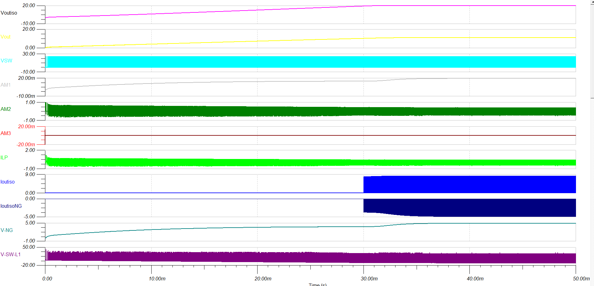

Now, My question is that ,why VG1(input supply) is sourcing 500mA and -500mA current ?  is it normal ? you can check AM2 graph at attachment.
Are there anything wrong with that circuit ?

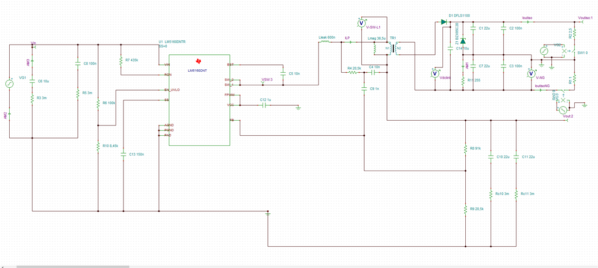

EDIT___
When I put the diode at input side I got this AM2 current graph.
