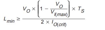

  • Are you trying to OR two power supply ? Is it for current sharing ? If it for current sharing this design wont work .
    Generally speaking, you cannot connect two devices in parallel to increase output current.  There is no mechanism to allow the two circuits to share the load equally.  One will tend to go towards current limit, while the other will be at light load.  You could conceivably use load sharing controllers to accomplish this.
    As far as DCM /CCM operation is concerned , the transition is dependent on various parameters and the minimum inductance needed to be in CCM mode for a particular current is given below :
    If you want to continue switching in CCM mode at lower load , you would need to increase the inductance . Use 68uH  as output inductor to continue switching at CCM mode .
    ---Ambreesh
  • Ambreesh-san;
    Thank you for your information.
      First, the purpose of diode-OR is redundancy as I replied on Jan 10, 2018 9:50 PM.
    Total current (=1.6A max.) is far below the allowed max. current (=5A) of single TPS5450.
    Is it acceptable?
      Second,  I have read "SLVA059A - Understanding Buck-Boost Power Stages in Switch Mode Power Supplies", and agree with you.
