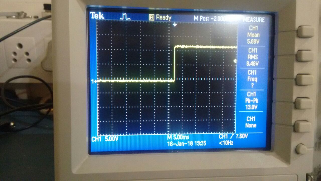

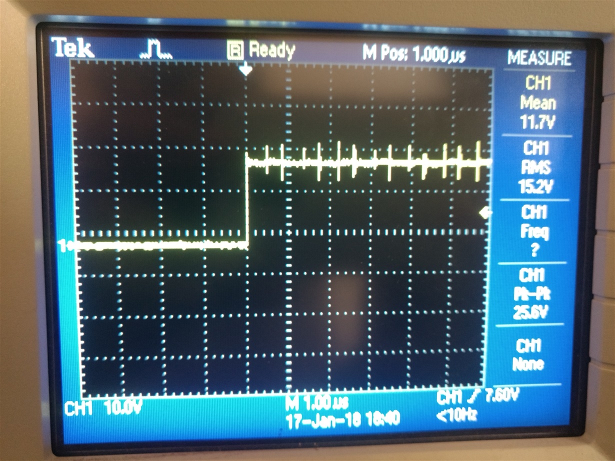

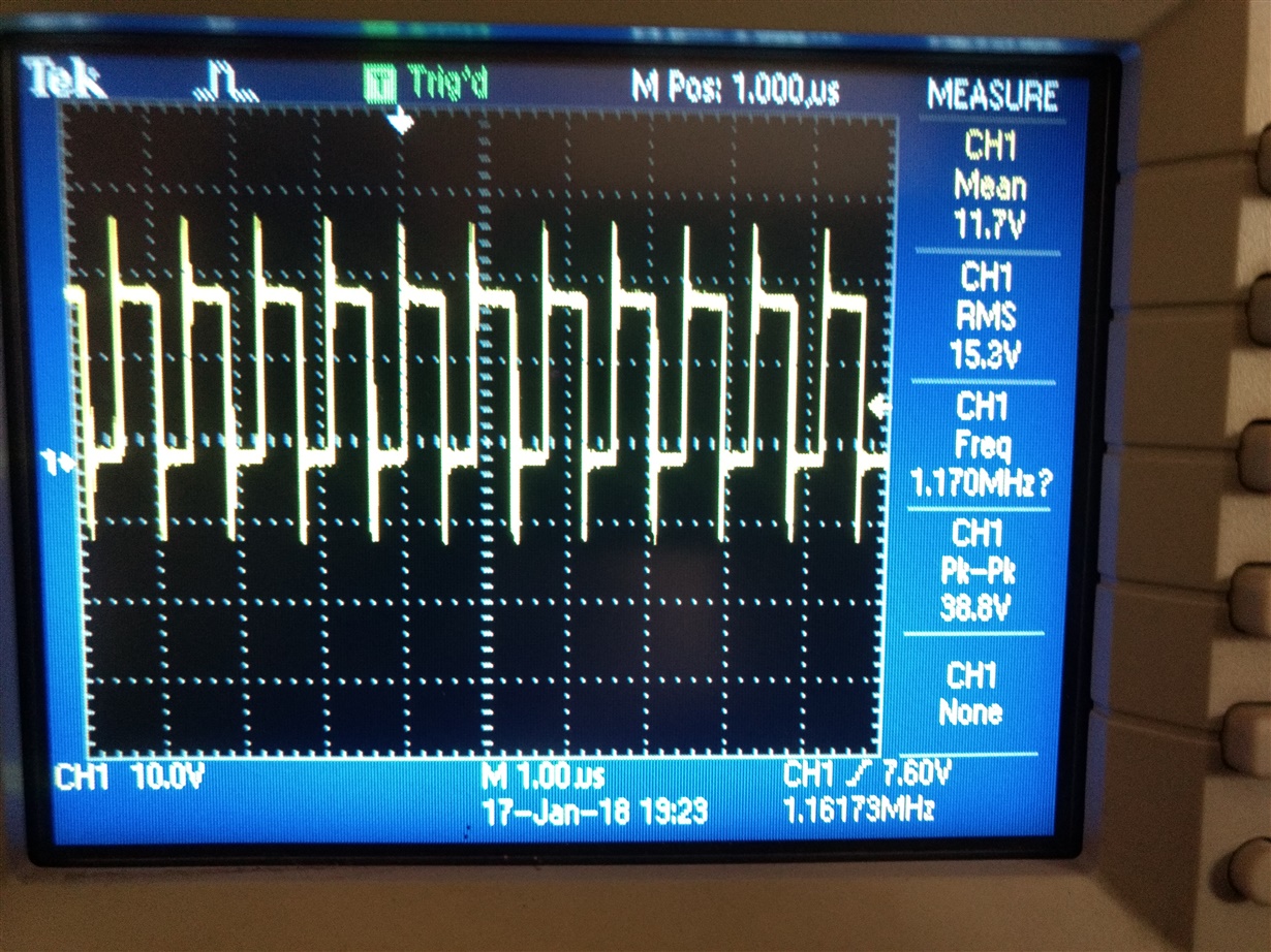

Hi
   We are using LMR14050SDDA converter, which is taken from TI webench. We are observing humming noise from the converter section. Below mentioned is the difference from the original design and our design.
  1. ESR of Cin is mentioned a 3.0mOhm in webench under properties but in the datasheet of corresponding part number(GRM31CR71H475KA12L) is showing 100mOhm and we have chosen 100mOhm.
  2. The mentioned quantity of the capacitor Cout is 2 which is in parallel but in our case we have used only 1.
The TI webench design is attached along with this post for your reference.
Can you please help us in eliminating the noise coming from the converter section.
