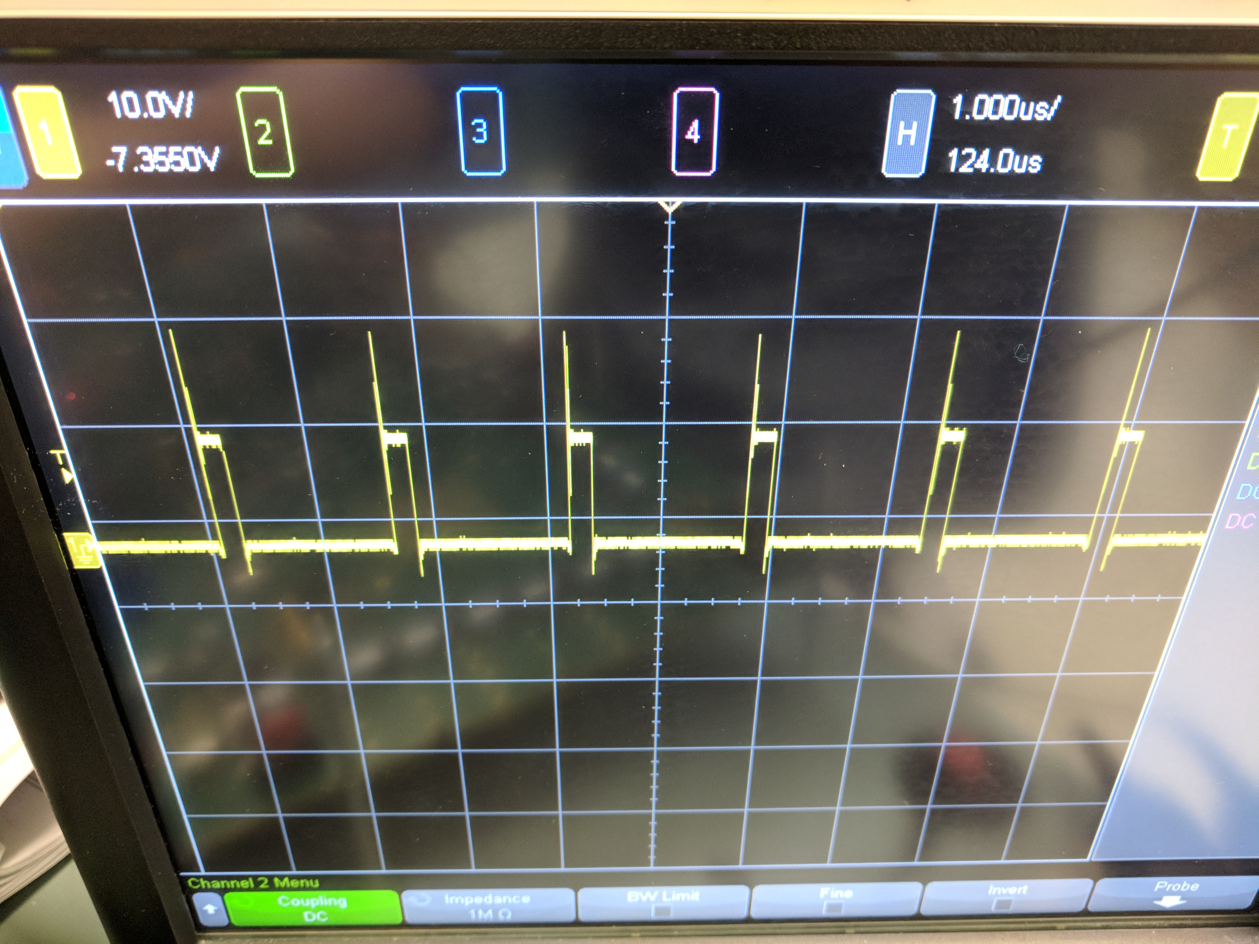

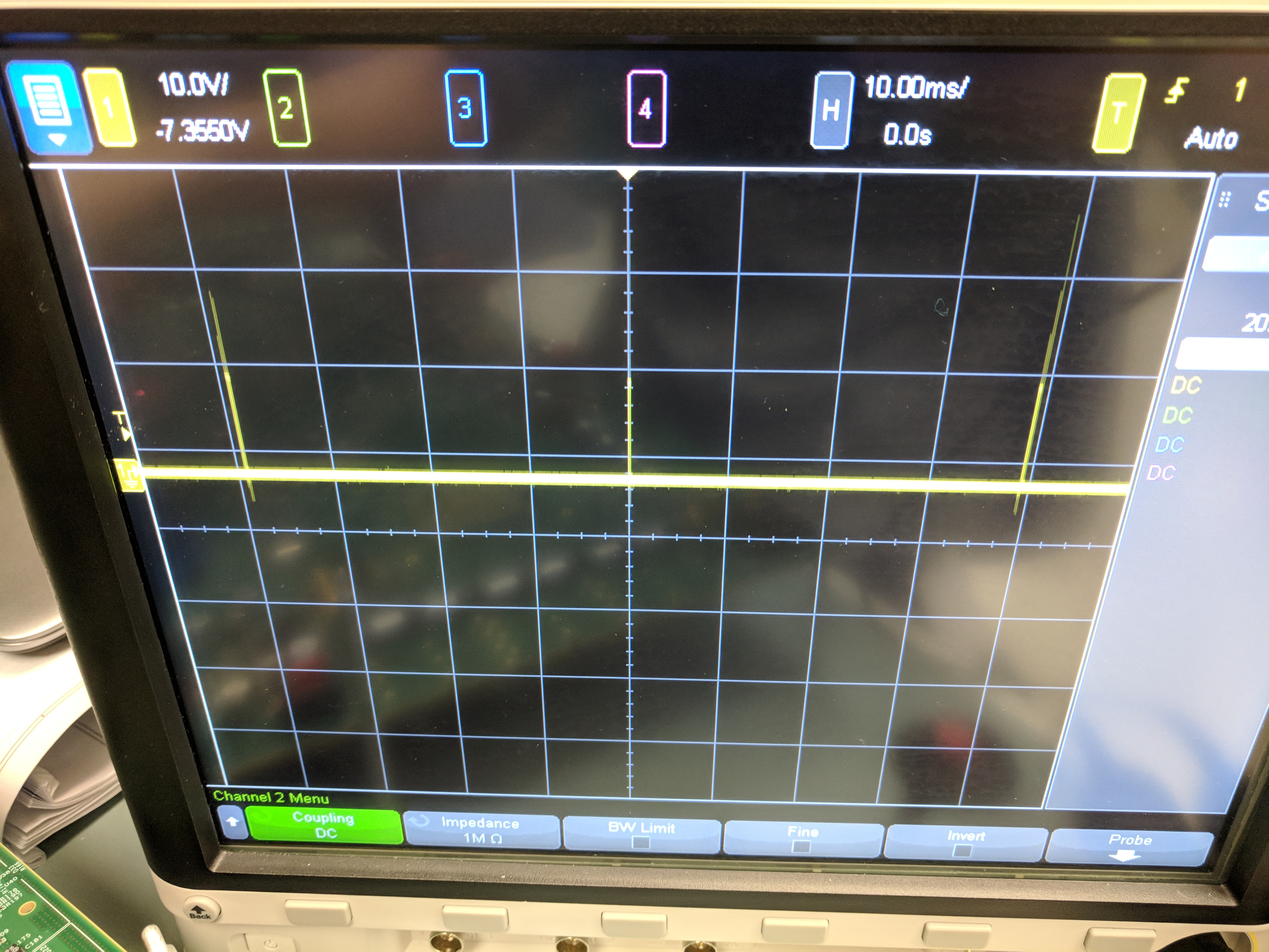

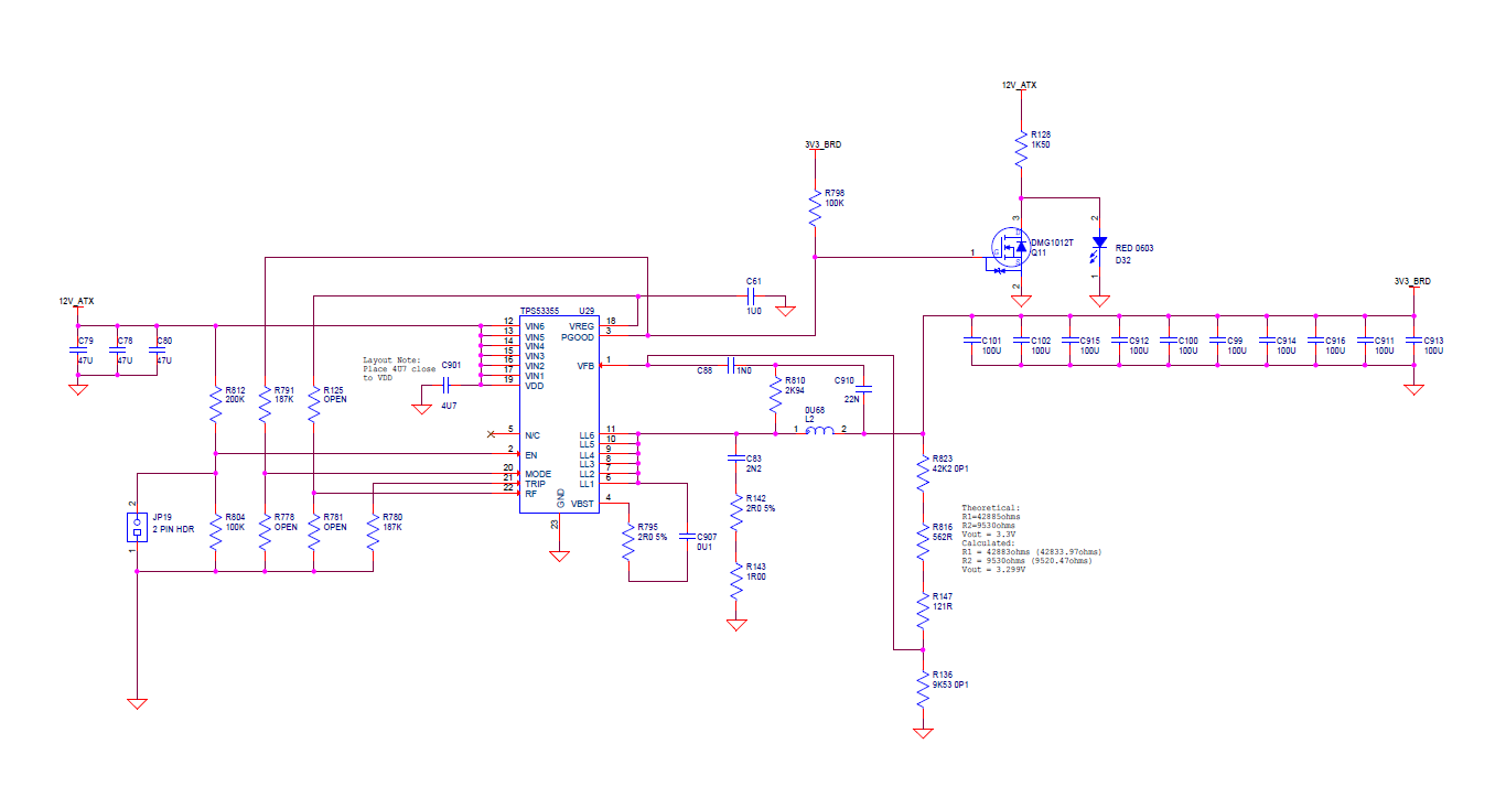

We have multiple boards with TPS53355 on them. The part is working well on all boards except one. I was wondering if you can help me debug this issue. Here is the schematics:
The en is 4v, input is 12v, vreg and vbst are 5v. output is 0v. When disable the part by putting a jumper on JP19, the vreg goes down to 0v.
There is a chance that on this board the 12v ATX goes unstable for a while. If it caused the part to be dead, I was wondering if there is a way to confirm that?
