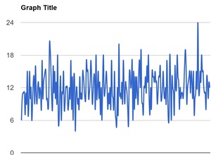

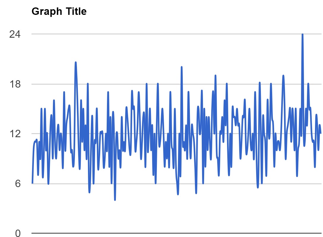

  • Hello, I am going to reuse my old topic.
    When I use TRNG_generateEntropyLessThan with one byte arrays and pass any type of upper bound limitation I can get only zeroes. Regular generateEntropy works very well and the results end up in entropyBuffer, in other cases they return zeroes. Below is the graph representing value appearances (0-255) after few hundred generator runs.
    I guess it works ok for regular function but I am not sure about the others.
  • Note that this driver is primary written to generate a private key for ECC. The driver is therefore written to generate large numbers since the key length is in the range of 128 bit and up. In an earlier post you asked about how to link the TRNG functions to easylink indicating that you are not using the driver to generate keys. If you want to return a 8 bit value, use the driverlib functions and not the driver.
