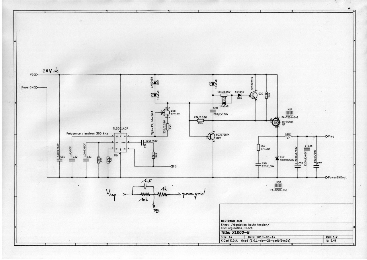

Good afternoon.
A few days ago, I was asking a question about a noisy self. I have done some tests and computed a snubber. Now, my schematic is :
I have added feedback divider by hand. I only use a simple divider with a capacitor.
Output power should be 200W (20A).

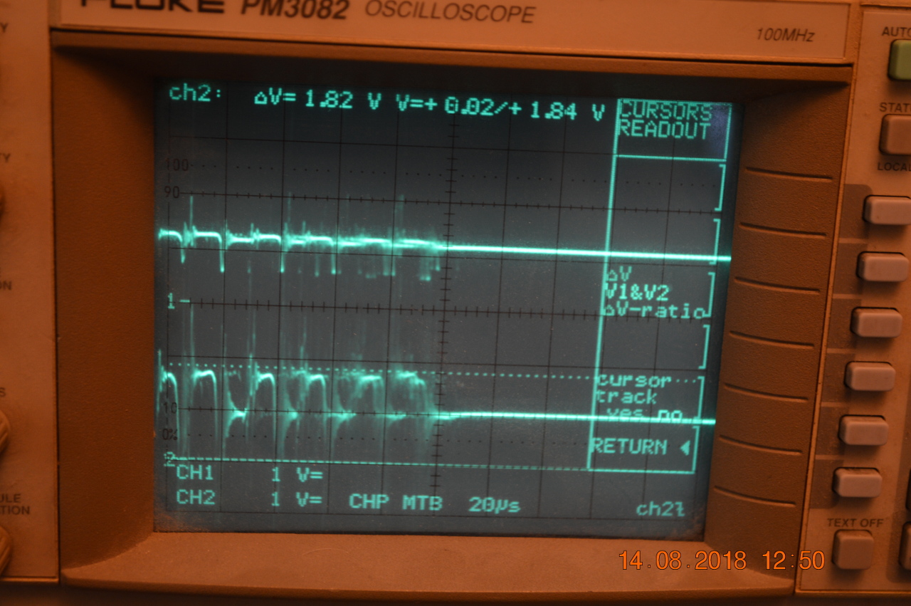

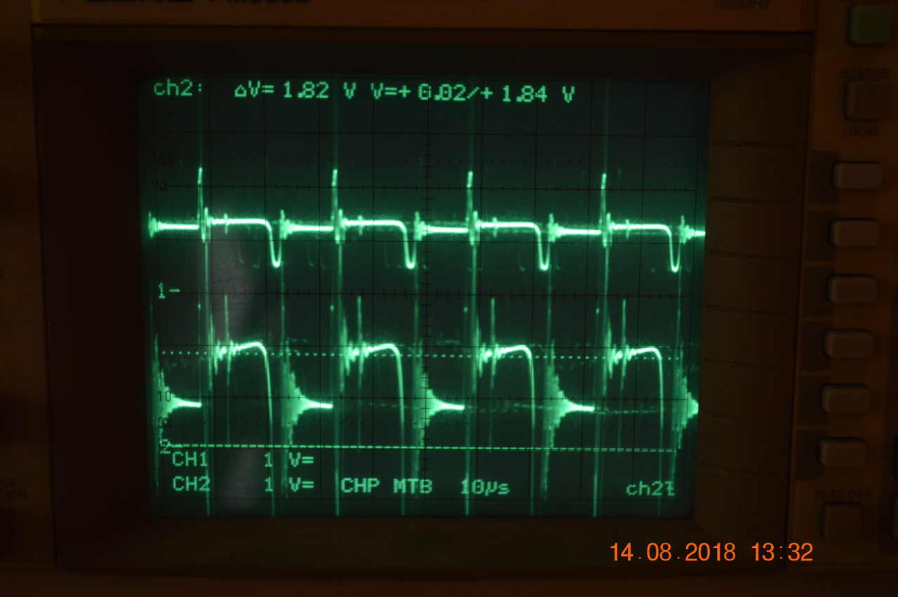

Whatever the output current, SCP signal remains greater than 1V. First diagram corresponds to a 100 mA output current :
First signal is output (11,5V). Second one is SCP signal. I have tried to modify C32 until 10µF without any result. Global efficiency is only about 65 % (!) when load consumes 6A.
Second diagram corresponds to a 6A output current :
Same constatations. SCP signal is too high.
I suppose I have done a mistake. In a first time, I don't understand why SCP signal is always greater than 1V.
Help will be welcome.
JB
  • I have found an issue in feedback circuit.
    Now, feedback circuit is :
    OUTPUT --- (10kR//(1.5kR + 22nF)) --- FB --- (100pF//(15kR + 18 nF)) --- COMP
    But there remains another problem. This circuit was designed to run with a 28V power supply and has to works at 300 kHz and it only runs at 75 kHz (I have tried to decrease Rt until 820R without any result, maybe Rdtc has to be modified also but I don't find any information in datasheet).

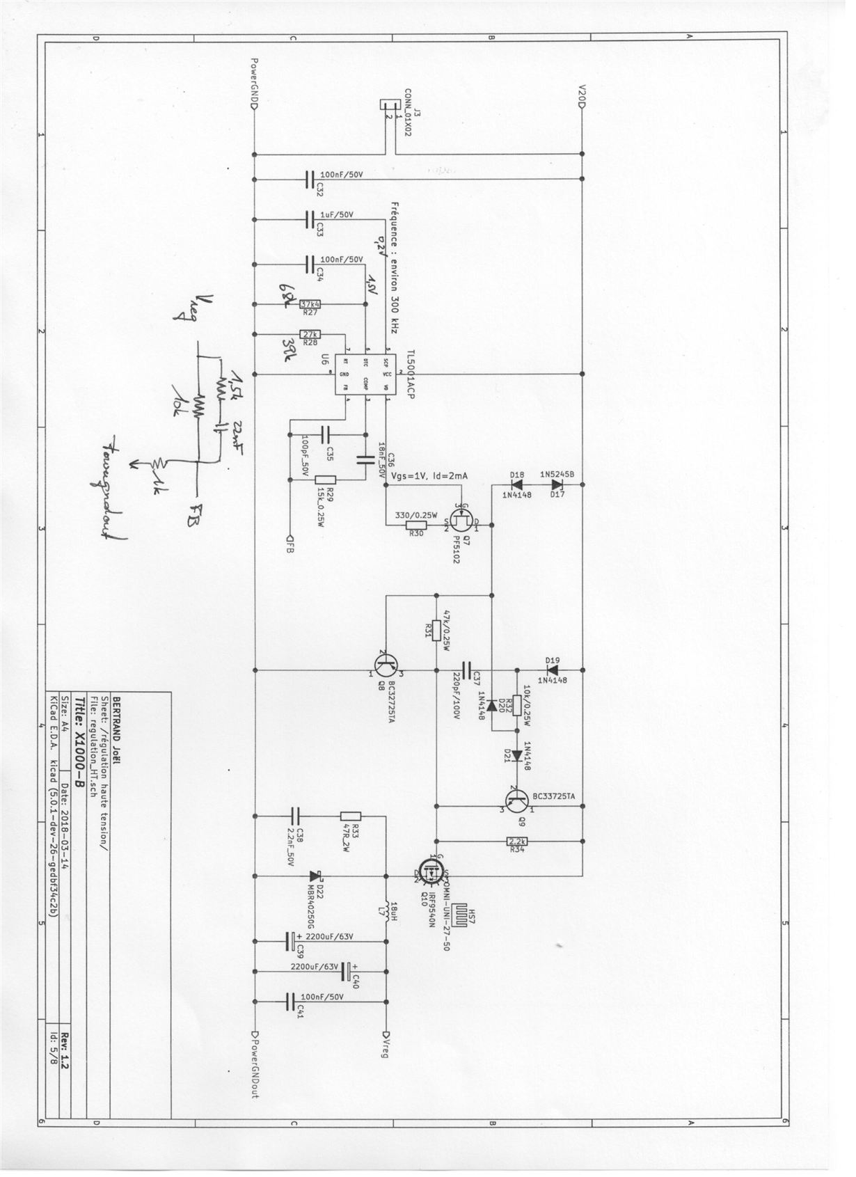

  • Some news...
    First,my current schematic :

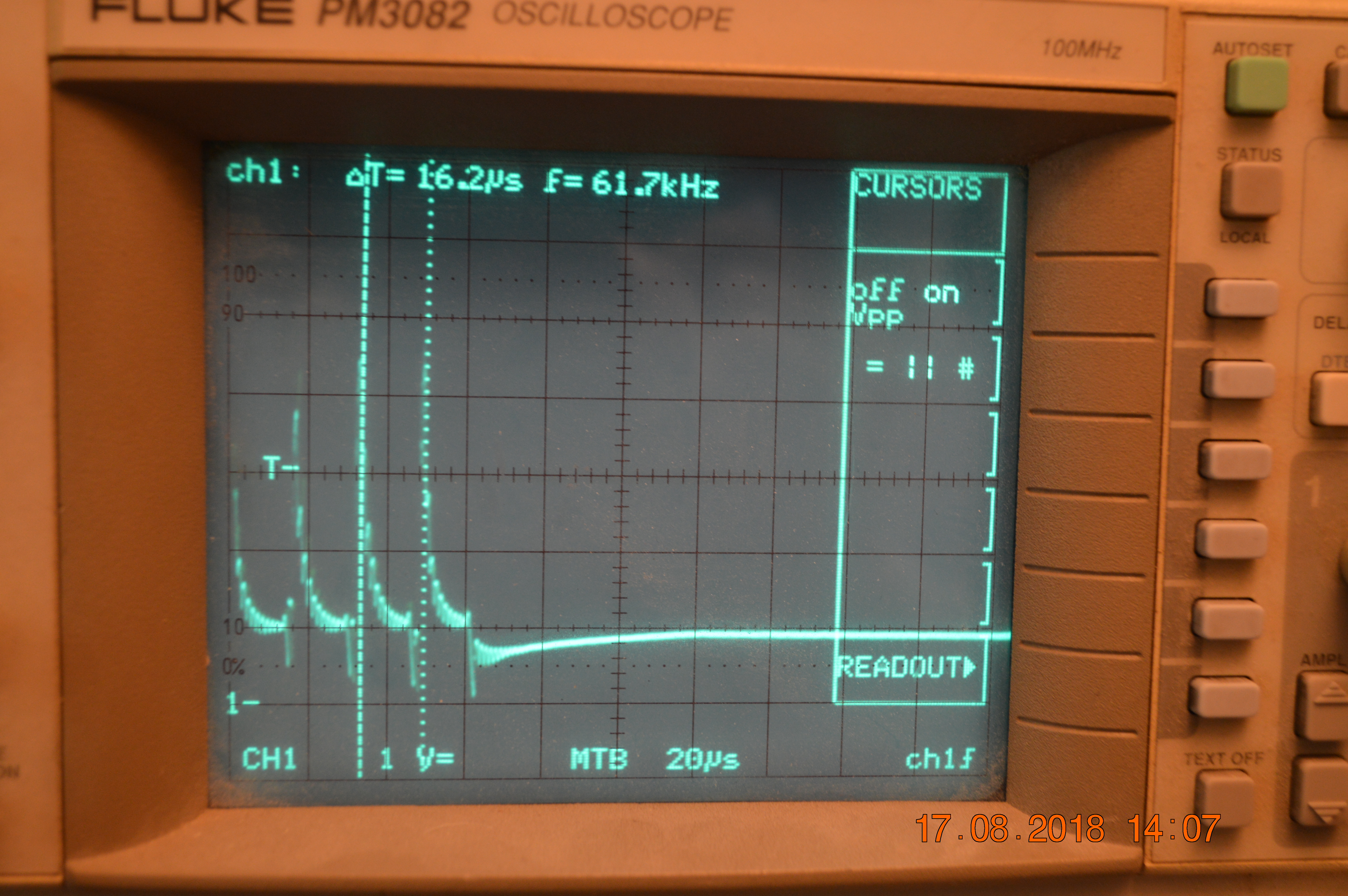

    SCP doesn't not exceed 0,2V. DTC is around 1,5V.
    First constatation : R28 (Rt in datasheet) fixes controller frequency. I have done some tests with 27k, 39k and some other values, I think that frequency is always around 65 kHz. I don't understand why I'm unable to fix this frequency at 300 kHz.
    Second constatation :
    This signal is taken on pin 7 of TL5001A (RT) for a 28Vdc power supply and a load that consumes 100 mA. If load consumes 1A, result is very similar.
    I don't know how analyze this measure. I suppose delay between two pics is the frequency clock. But, why does this clock stall for a long time around 1V ? Controller runs as expected during a few cycles and seems to stop for a few moment before restarting. I'm not sure this behavior is normal. For me, if load consumes enough current, controller has to switch every cycle.
    JB
  • Hello Jasper,
    I think I have found half of the solution. I have to quicker discharge Miller capacity of the IRF9540. With a stronger polarization of the PF5102 (10mA), controller works better (@ 200 kHz, without bursts) but Q8 sees 14V/650mA when this capacity is discharged and ends up burning.
    JB
  • Hi JB
    Where do the 650mA come from? The circuit should limit the current through Q8. or we can add a resistor to limit the current.
  • Hi Jasper,
    The 650 mA comes from both grid capacity of Q10 and bootstrap capacity C37. Q8 can drive 650 mA but Q8 emitter voltage is between 14V and 28V (in my case as Vcc=28V). Thus, Q8 dissipates too much power and burns causing the death of Q9 (for the same reason). I have added between Q8 collector and ground a 1N5349B (zener with Vz=12V) and now, both BC327 and BC337 dissipates around 270 mW and the Zener only 510 mW. I can limit the current in Q8 by limiting its base current. It's easy, I have only to increase the value of R30. If I do that, Q8 collector current is weaker, but this current is not enough to discharge Q10 grid capacity when controller runs at 300 kHz.
    I haven't tested with a real circuit, I have to make a new PCB to do that.
    JB

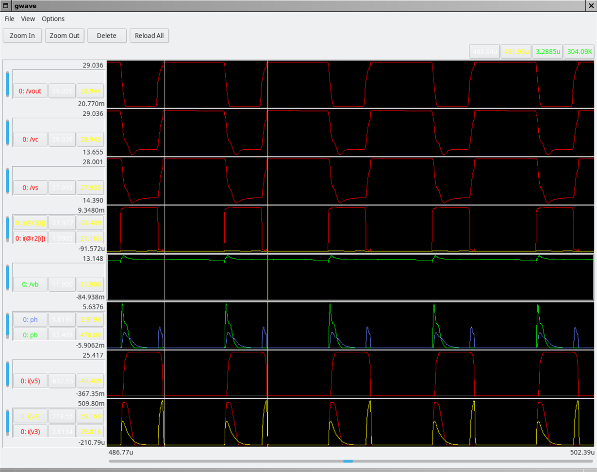

  • And results of Spice simulation :
    i(v3) and i(v4) are currents in BC327 and BC337. Vs is MOSFET grid voltage. Ph and Pb are power dissipated by BC327 and BC337.
    JB
