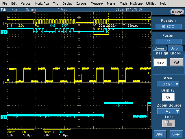

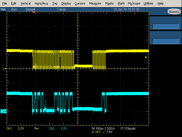

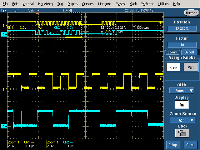

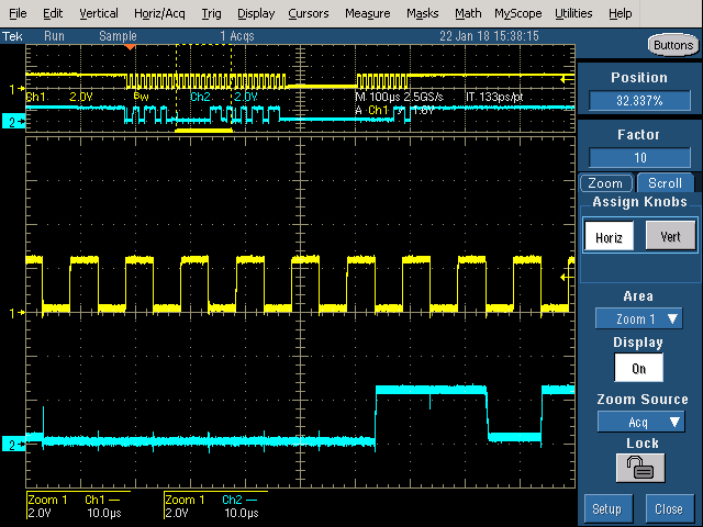

  • Hi Gerard,
    Are you reading values from any registers other than VDD1_OP_REG (0x22) or VDD2_OP_REG (0x25)? If those are the only two, it might indicate that you are using the SmartReflex I2C bus instead of the normal I2C bus.
    I just took screenshots of an I2C read from the "DAYS" register (0x03) which has a default of 0x01, can you compare them to your scope shots and see if anything is missing?
    Zoomout:
    Zoomin1:
    Zoomin2:
    Zoomin3:
    Zoomin4:
  • Kevin,
    I am pretty sure I am addressing the correct device.  When I read register 0x1c, PUADEN_REG, the code sees 0x9F, the default value.
    On register 0x03, I see a similar scope trace to yours.  The '1' bit is there, but the 0x01 expected is not showing up in the I2C controller read data register.  So this no longer looks like a PMIC problem.
