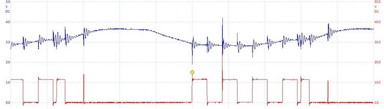

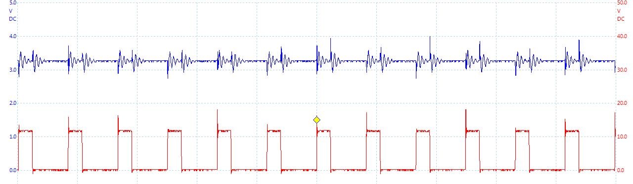

    However, while I do get a steady PWM train most of the time the chip seems to randomly change the output waveform to one of two others.
    Below is the usual. Blue is output (3.3V pin) while red is the secondary dot pins of T1. I've confirmed that is the waveform coming out of the chip's OUT pin.
    It then randomly changes to the below, so far as I can see with no external stimulus. It generally settles here for a minute or so.
    Then changes again to the below, which is similar but noticeably different. After doing this for ten or twenty seconds it goes back to the first waveform for a while.
    All three conditions are stable (that is, the chip is consistently outputting the same waveform for the duration) until it changes from one condition to another. Where probes are connected seems to alter the behaviour, such as not connecting a probe to the output appears to make it far less stable.
    This looks like the chip is hovering right at the edge of some transition between states. Does anyone have any suggestions as to what's going on?
