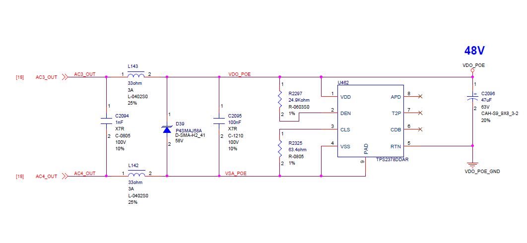

Dear Sir,
We design a PoE Anchors module. When we connected to the four PoE Anchors module, when the fourth PoE Anchor module was unable to supply power properly, we measured the voltage of the PD to be oscillating around 40V, such as below picture.
When just three modules are connected in series, the power supply can be normally performed. For example, the picture of the accessory, we measure the normal voltage of the PD voltage to 55.2V.
Such as below picture.
Can you let us know why? How to resolve the problem of connecting four modules in series? Thanks!
