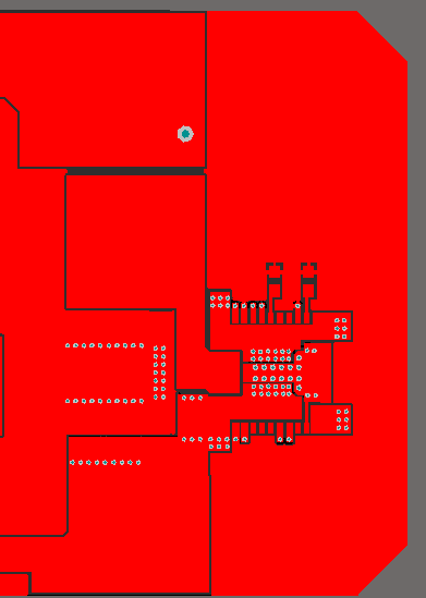

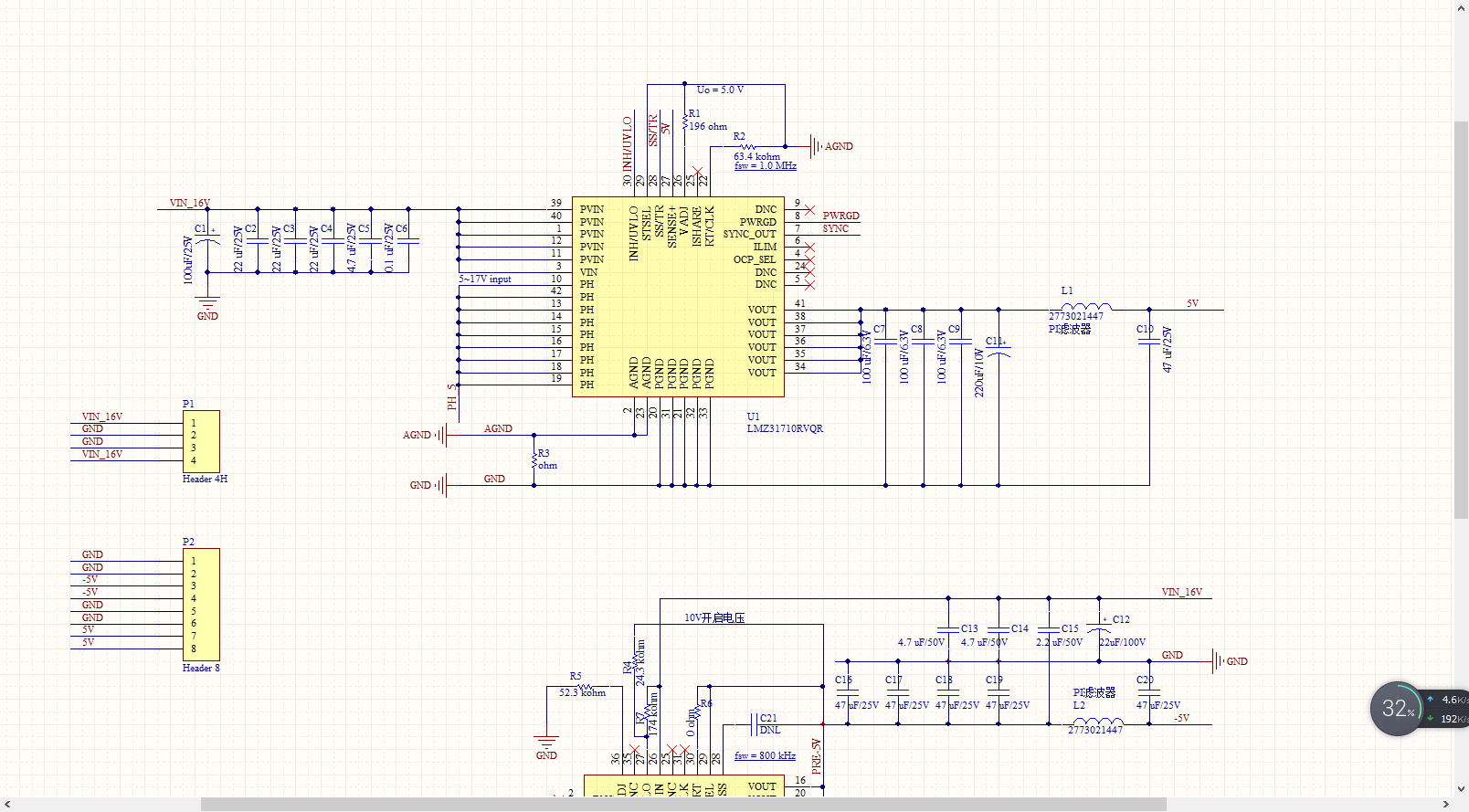

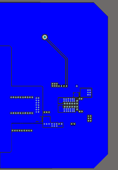

In my design LMZ31710 is used to generate 5V from 15V.  schemetic and PCB layout is as below.
when there is no load or the load is light (~1A), the output is normal as designed. However, when the load is heavier (~3A), the output is near 0V.
I tested the VADJ pin in both situation. in light-load situation, VADJ=0.59V; while in the other situation, VADJ~0V.
PCB layout:
TOP OVERLAY:
TOP:
A1:
A2:
BOTTOM:
  • Hi user4460468,
    To better understand your setup can you provide answers to the following questions:
    • What is your power supply's current rating and what circuits in your system runs off the PS rail?
    • Can you provide scope-shots of Vin, PH, and Vout?
    • Have you tried shorting out the ferrite bead for the heavier load application?
    Jimmy
