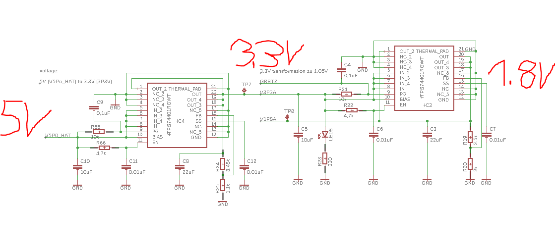

TPS74401RGWT
 on the Picture you could see my voltage design. is this design correct?
  • Hi Mario,
    The schematic you provided will generate the 3.3V from 1st stage and 1.8V from the 2nd stage. Please see my additional comments as followings:
    1. You have PG connected to the Vin. Usually PG is tied to Vout because when device is disabled, PG path won' t sink current due to Vout is OFF. When you have PG connected through a resistor to Vin, you will have a constant path to ground even you have the device disabled.
    2. You don't have to put the resistor between Vout and Enable pin.
