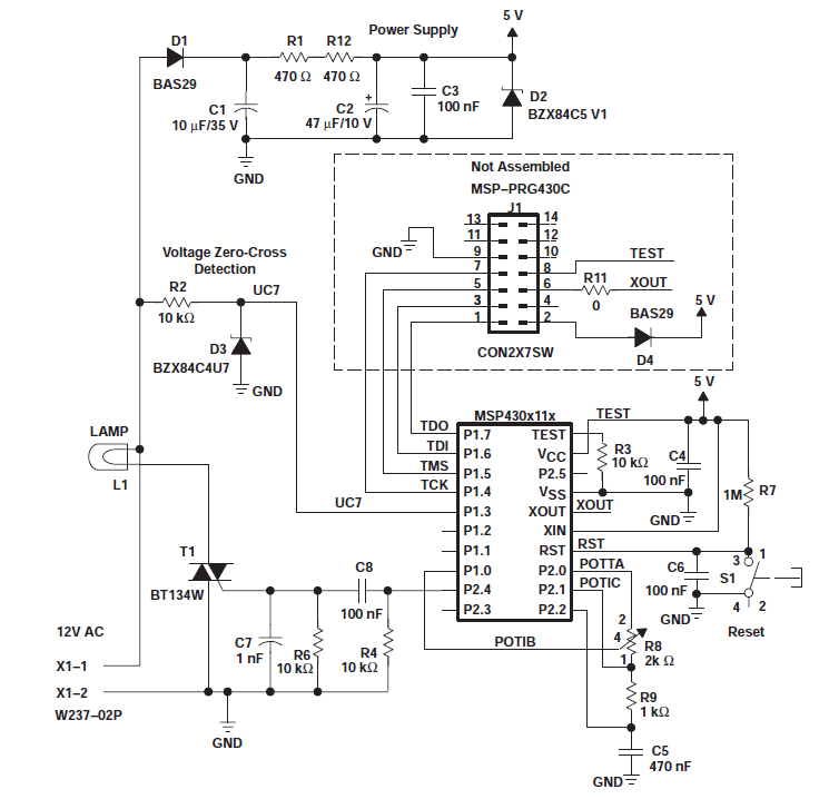

      Thank you for the additional information in the block diagram.  As previously stated, since TI does not have an eval or Ref Design for your requirements, you will have to do some additional research for each of the main functions.  For example, the MCU might be an MSP430, and there are a number of Ref Designs with that uC.   Also curious about the remote monitor - you mentioned LAN, so would this be hard-wired cable, or would you use a wireless network?  Either way, there are Ref Designs for either method.

  • As previously stated, since TI does not have an eval or Ref Design for your requirements, you will have to do some additional research for each of the main functions
    Yes, I do agree with you. At this moment I am thinking a zero crossing detection circuit for synchonization. Actually the diagram I have posted is main the concept. Later on  I will try for a firing angle control circuit and gate driver. Lets adapt this 2 function in a TI MCU or DSP. I think I need to use few MCU for this design.
    Take a look the classification, dont you agree with this diagram?
    Dont you agree with this application, lets find more suitable one for SCR.
