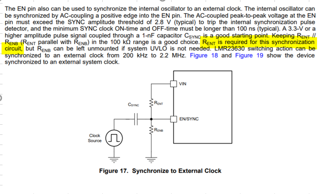

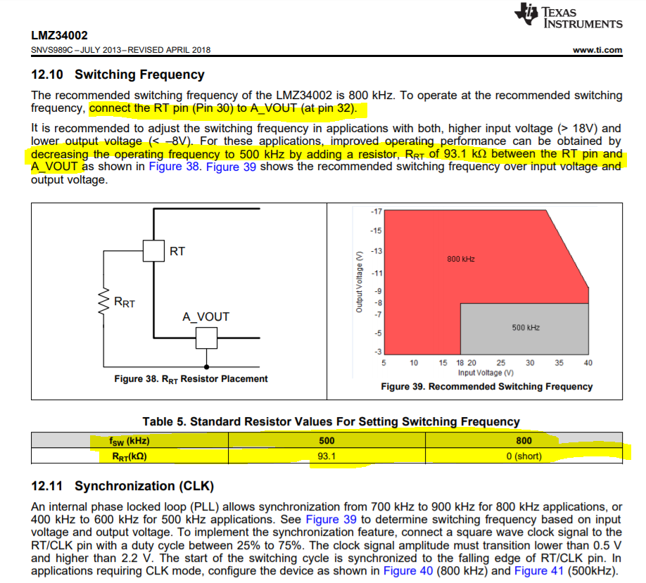

I am thinking of using the LMZ34002 to produce a -9V output at roughly 0.5A. The board it would be included on has many other DCDC Converters all of which have a SYNC or CLK pin connected to a 625kHz external clock. While this value is not one included in the options mentioned in the datasheet (400-600 or 700-900 kHz), it is between these 2 ranges and relatively close to 600 kHz. Would it still be possible to sync the LMZ34002 to this 625kHz clock? If so, which frequency range should it be programmed to (400-600 or 700-900)? If not, how would the out-of-range frequency affect the performance of the converter?
