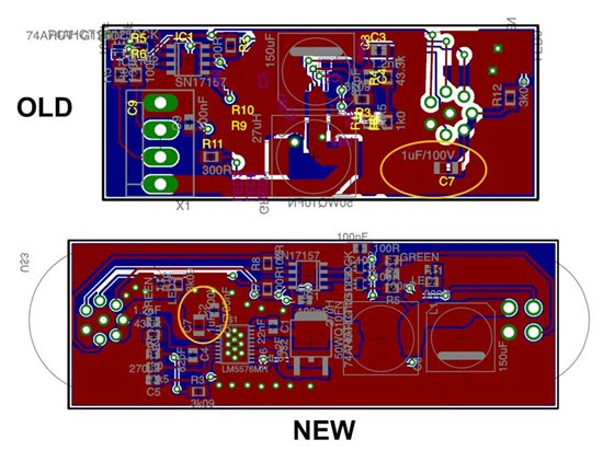

    I have attacehd my pcb layout.
    I have looked at the pcb layout and i am wondering how much of this could be a problem.  I have reworked the pcb design and i'm about to try somethign different, with a layout that is only single sided, with a ground plan on the back. Hopefully that will be
    Old PCB

    I would be very interested to know how the PCB layout can affect the design so much?
    Replacing teh LM5576 after the failure, solves the problem, so it looks like it is failing..

    Bad board layout (i.e. improper input cap placement on a buck converter) can cause large spikes on the switch node due to parasitic inductance in the high di/dt loop. These spikes can go over the abs max on the SW pin (depending on how fast the switch transition is and how much parasitic inductance there is) and damage the device. I don't think this is happening in your case. Your input voltage is way below the operating maximum and the placement of the power stage components looks OK to me.
    I will review the schematic and layout again in more detail later today and provide some more feedback. It would be beneficial to probe the input voltage, sw node, and output voltage with a scope and get an idea of the device operation.

    I'm sorry that I misunderstood your earlier post. I reviewed your new board layout earlier and mentioned that it looks good. However, you are probably getting the failures on the old layout, which is not optimized. In particular, the capacitor C7 (the input cap) is very far away from the IC and also sits on a different layer than the IC. The input capacitor is not doing much when sitting that far away from the IC. Your new layout is much better.
    Because of the cap placement there is a lot of parasitic inductance in the switching current loop.This will result in a lot of noise and high switching spikes. If you probe the switch node with a scope I am sure that you will see quite a bit of noise. This will get worse as you increase the output current because the di/dt gets larger.
    The good news is that your new board layout looks very similar to the evaluation board and the evaluation board with your BOM behaves normally. Here is a link to the evaluation board app note: http://www.ti.com/lit/ug/snva210a/snva210a.pdf for more details on that layout.
    I think this verifies that the list of components is good and it must be a layout issue. I believe that the design will work properly on your new board layout. If you would like, you can also try the components you got on an evaluation board and verify it with the rest of your system.

  • Andrew,
    I ran another experiment on the evaluation board, again to point to the issue with the old layout. Here is a picture of this, the cap is sitting on the two input wires:
    I placed the input capacitor farther away to replicate your old layout. Here is a scope shot of the switch node with the cap "close" and the cap "far" from the IC. Notice the increase in ringing and spike amplitude.
    cap "close":
    cap "far":
    Finally, I shorted the output of the regulator with the input capacitor being far away and the device got damaged just like in your case.
    I think this is another confirmation that the layout has to be modified.

  • Firstly i'm totally blown away by the level of support that i've had.   You've gone way past what i could have dreamed for. Thanks so much.
    I've jsut run some tests imilar to what you dod with the Cap on PCB and i get a spike that is a bit higher than yours. at about 112V.
    We are just manufacturing PCB#2, and i hope to give it a try shortly, and i'll let you know how we go.

  • Moving the input capacitor made all the difference.  Its all working very nicely now.
