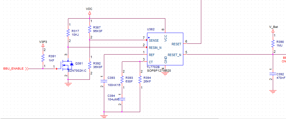

I use TL7702B for my new project. My schematic is shown as follow (figure 1).
I measure VCC, Reset_N and CT pin (the following fugure 2).
Q1: Is the reference voltage 2 2.53V?
Q2: If the reference voltage 2 is 2.53V,
Why When CT voltage up to 1.9V=> trigger Reset_N , (CT voltage should up to 2.53V then Reset_N )
From datasheet block diagram (fugure 3)
