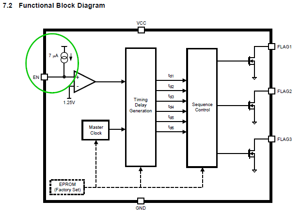

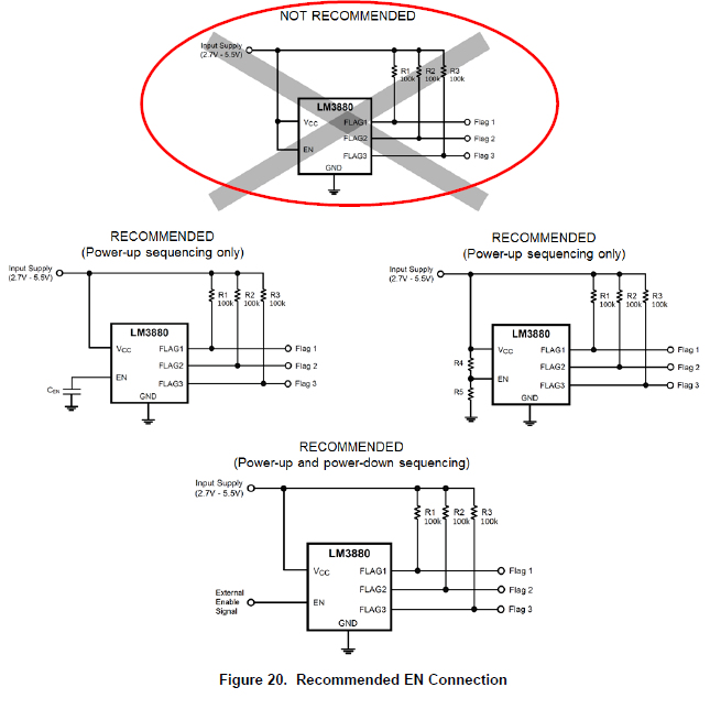

  • David,
    There is 4.7V on the open EN pin because there is a 7uA current source from VCC connected to the EN pin internal to the device.
    So if the EN pin is open it will follow the VCC pin.
    And this is basically equivalent to having the EN pin tied to VCC at power-up which the datasheet does not recommend, see below.
    The EN pin should be exercised to active (High) after the device is powered up.
    For the last recommended case above, External Enable Signal, I would ensure that the EN pin is low before applying VCC otherwise you will be equivalent to the not recommended case again.
    Also, if you are seeing 2.7V on the FLAG pins with the EN pin High, then the FLAG pins are active but the voltage from the pull-up is being limited by something external to the sequencer,  I interpreted your post to indicate that the LEDs are tied from the FLAG pin to ground, this would be the likely source of voltage limitation.
    If the Enable was low then the FLAG pins should be <0.4V.
    The Pull-up resistance is probably too high to light the LEDs if you are using 10K or 100K resistors.

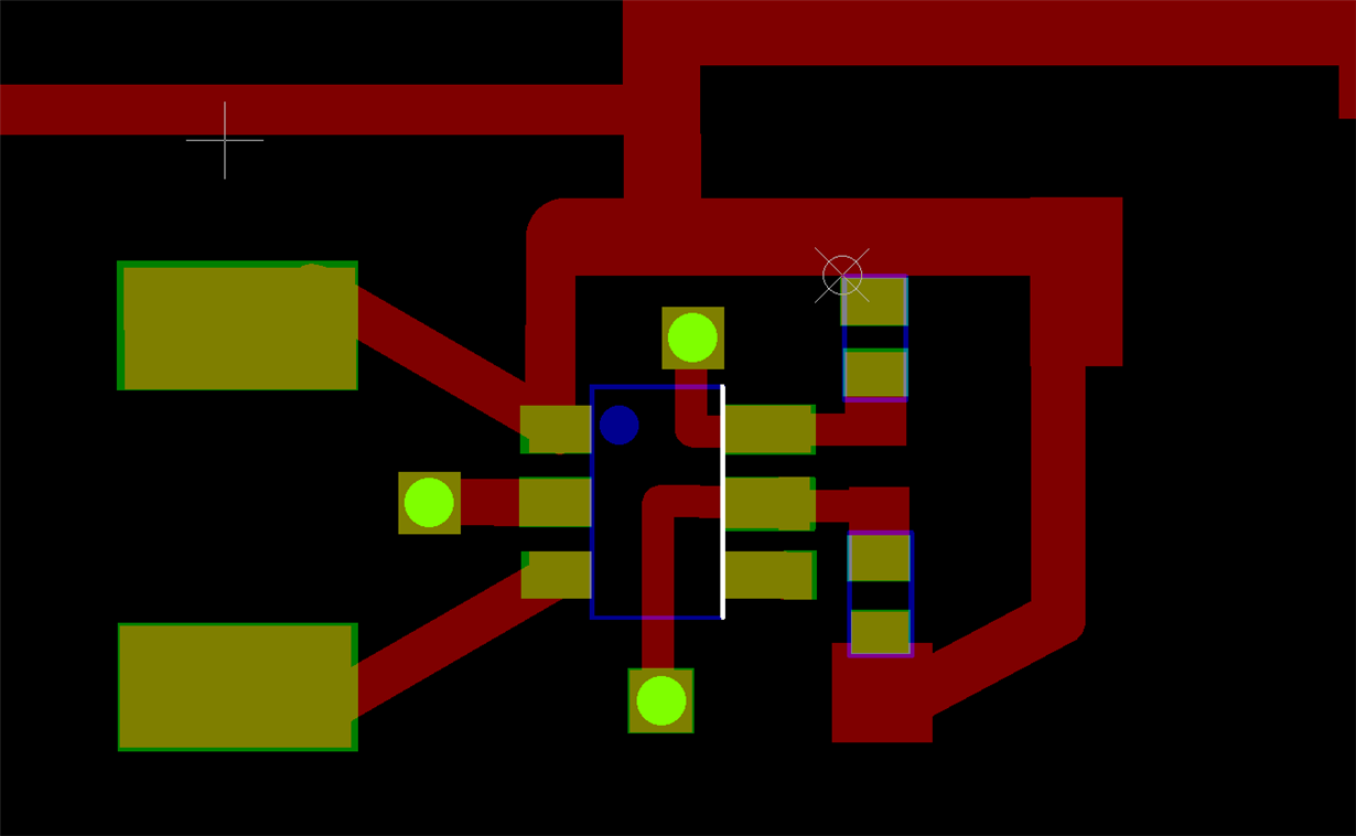

  •  Hello
    OK thanks your detailed answer
    so I cannot use the same 5 v PSU than the Vcc ?
    I link the pcb screen shot I use a manual toggle switch between EN and Vcc
    Shall I use another 5 V PSU ? as I have understood that I shall NOT drive EN and Vcc in the same time but that not written I shall use another PSU source ??????
    David
  • David,
    You can use the same supply, but the switch connecting VCC to EN will need to be open at power up. And because the EN pin will be sourcing the 7uA, you will need to add a resistor from the EN pin to ground that will hold the pin below the minimum enable threshold of 1.0V during power up of the VCC rail. A 10K ohm on the EN pin to ground will hold the voltage to 0.07V when the switch is open.
  • thanks you are right That mandatory to NOT let EN pin floating but use a resistor ( 10K) that work now
