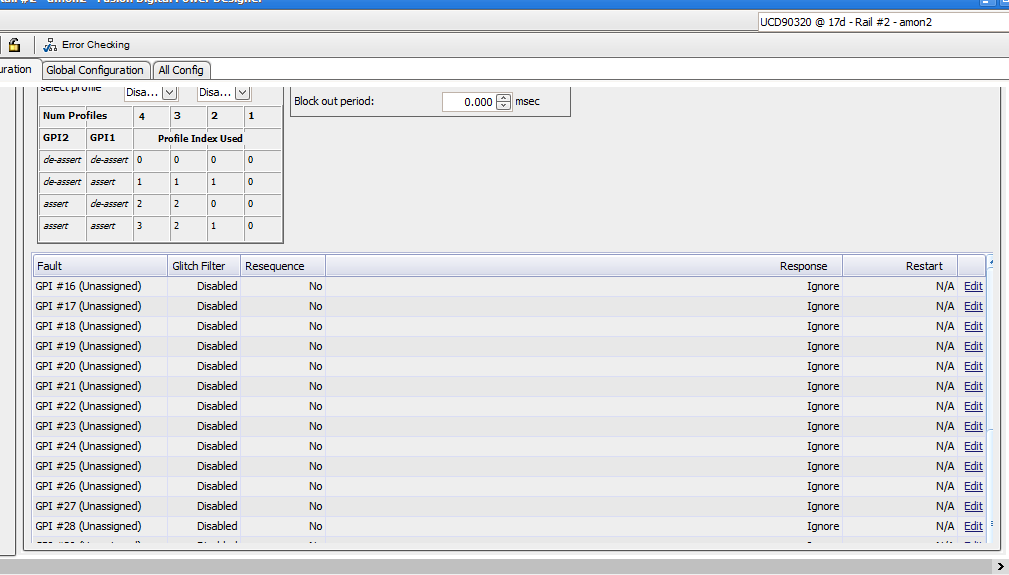

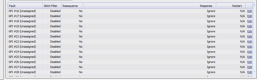

  • HI,
    I have configured Pin L4 LGPO13(GPIO) as GPI fault enable. The fault on it should trigger shutdown sequence.
    When I tried to assign this functionality in the fault response I'm not been able to see LGPO13 only.
    Thanks and regards,
    Ashwath.
  • Ashwath
    do you prefer command over GPIO? how do you turn the rail back on later on?
    If i were you, i would use CONTRL_PIN( for example ACTIVE HIGH), by default CONTROL_PIN is high, so when UCD is out of reset, it wil read the CONTROL_PIN state, it will turn on all rails if it is high. there is no need for commands or other signals. under exetremey case, you can pull the CONTROL_PIN low, than the rails will be off. you can toggle CONTROL_PIN high to let UCD to turn rails back on again later.
    Yihe
  • THe GPI #16 is not the phyiscal pin and instead it is the index of the GPI you assigned.
    Which GPI was assigned by LGPO13?
    Yihe

    I want amon1 and amon2 to shutdown when GPI #1 is low. When I tried to assign that in fault response I'm not seeing any LGPO13. All that I can see are the GPI #1 to GPI #32 and all the GPIs were
    showing unassigned.
    Now which GPI pin should I have to assign in order to get the desired result.?
    Ashwath.

    I have configured GPIO4 as GPI fault pin. I'm controlling it using GPO MAR13.
    I have set in fault response of GPI #01 and bingo I'm getting the desired result.
    It should have been GPI #04 fault which should cause the shutdown right?
    How the GPI pins are mapped in fault response list?
    Like I have configured GPIO 4 as  GPI fault pin in hardware config.
    But I set GPI #1 in fault response. Whats actually happening here?
    I have attached the config file
    test.xml
    See this config file. I have set MAR 04 pin as GPI fault pin .
    But in fault response I'm using GPI #1 and  I'm getting the result.
    3630.test1.xml
    Can u explain me how the mapping of GPIO pins are done in fault response?
    Ashwath.
