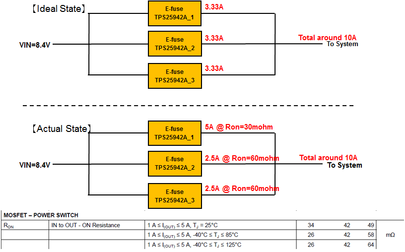

Hi Team,
Our customer would like to use TPS25942A at the following conditions(Load current is around 10A).
Because, they needs the current monitor and reverse current blocking and diode mode.
Therefore, they would like to use this device.
Can this device operate the parallel operation?
I guess that if TPS25942A_1 and TPS25942A_2 and TPS25942_3 operates at the same time,
the actual current of each device varies by " variation of ON resistance between each device ".
Could you please let us know if you have any concern?
