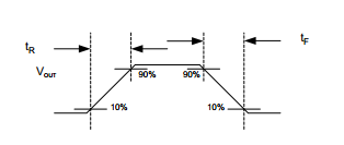

    When you say that the "off slew rate is only 6.6us" do you mean that the output voltage falls from ~90% to ~10% (tF) in 6.6us?
    Could you post a scope shot of off the fall time?

    The peak reverse current should be no more than 733mA and will be stopped within 10us. The fall time of your device is dependent on the load current or the load resistance on the switch. The datasheet is spec'd at a load resistance of 10ohms, but your system may have a different load and therefore a different fall time.

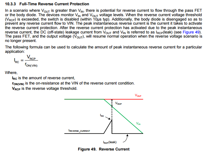

    Many Thanks, that's very helpful, where does the 733mA come from ?
    Simon
  • Hey Simon,
    The equation to calculate peak reverse current is:
    Vrcp and Ron(vin) can be found in the electrical characteristics table shown below:
    Vrcp = 44mV and Ron(4V) =~60mohms
    Ircp = 44mV/60mohms = 733mA
    if you have any other questions let me know.
