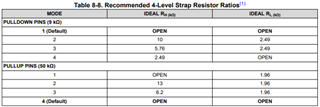

    Is the COL pin of PRU1 currently pulled both up and down (via R151)? If this is the case then the PHY could be strapping to fiber mode which would cause the problem. If you remove the PD then PRU1 will keep a different PHY address without strapping fiber mode.
    Additionally we recommend following this table for strap resistor values. Please not that COL is internally PU and RX_D0-RX_D3 are PD.
    You can also double check registers 0x467 and 0x468 to confirm your strap settings.
