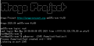

I created a debug configuration file as follows.
Then I started to debug, but I got an error as follows.
( Connection type is telnet. )
On the other hand, I execute this command "gdbserver :2345 /home/root/test;exit" manually, this error didn't happen as shown in the figure below.
Why did this error happen when using CCS ?
Can you reproduce this issue ?
Please teach me how to fix this issue.
I used tisdk-default-image-am335x-evm.tar.xz in the latest SDK for target filesystem, and copied "test" binary file to the target in advance.
