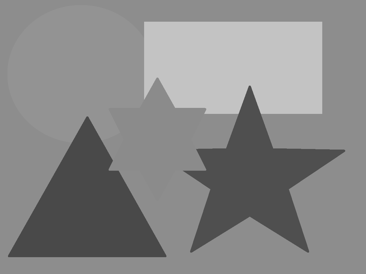

Using TIOVX APIs, I ran vx_experiment_image_scale_1280x960_1024x768 (void) described below to resize the image.
When I executed this with the settings to be processed by VPAC, there was an error in the output image.
Like the inserted image, the output image looks like being shaded.
How can I get correct output image with VPAC?

Below is the Input image (1024x960).
Input image
Below is the output image (1280x768).
Output image
Takanori Sakata
  • Hi Takanori Sakata,
    From the above code, it looks like you are reading BMP image, typically BMP image is in RGB format, this is not supported in the MSC. So can you please check the input image format and use the correct image format?
    Brijesh
