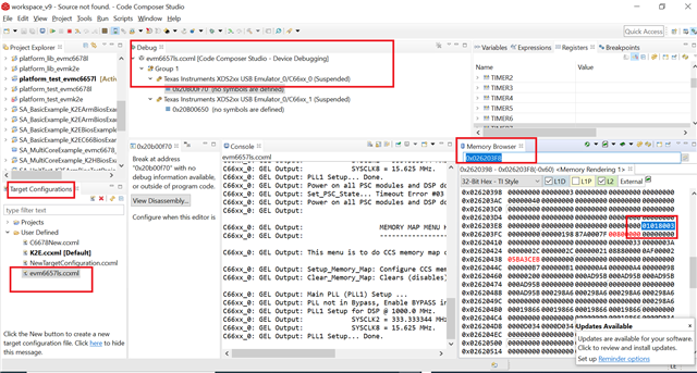

    1. You can query the "DEVSPEED" register, whose, value gives the maximum core frequency you can set for the device.
          --> for example, in C6657 product, when I query the value of  the DEVSPEED register address, "0x026203F8" it gives the value 0x01018003 -
                convert  the value 0x01018003 to binary - 1 0000 0001 1000 0000 0000 0011----> map with the Table 8-20. Device Speed Register Field Descriptions -- page no : 223 in Data manual of https://www.ti.com/lit/ds/symlink/tms320c6657.pdf --- > 0000 001xb = 1000 MHz
    Similarly, you can query the same DEVSPEED register for C6654 and C6655. The max frequency will be 850 MHz for C6655 and 600 MHz for C6654.
    This is what I did
    steps:
    1. In CCS, Create a target configuration file with appropriate gel file ( For C6657, C6657-gel-file. For C6655, C6655-gel-file)
    2. Launch the *.cxml file and load the gel file.
    3. open the memory browser, and feed the DEVSPEED register address, " 0x026203F8"
    4. Get the value, convert to binary and match with the data manual-field descriptions of DEVSPEED.

  • Hi Shankari,
    Thank you so much for your answer. They confrimed the following values in the DEVSPEED register on each devices even if they intentionally set 850MHz and run each device.
    C6654 : 0x00810003 => 850MHz
    C6655 : 0x02010003 => 1250MHz
    C6657 : 0x02018003 => 1250MHz
    They decided to use this solution.
