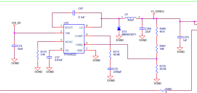

    If motor driver would not be used/connected, can the customer only use 5VDC?
    Do you mean to only provide a 5VDC input power supply instead of 24VDC since motors are not implemented in their use case? I am not an expert in the TPS5402 buck converter, but the way it is configured on the EVM looks specifically to regulate an input supply of 24VDC. I do not think the buck is configured correctly for 5VDC input.
    DM: https://www.ti.com/lit/ds/symlink/tps5402.pdf?ts=1640189876316&ref_url=https%253A%252F%252Fwww.ti.com%252Fproduct%252FTPS5402
    IDK Schematic Snippet:
